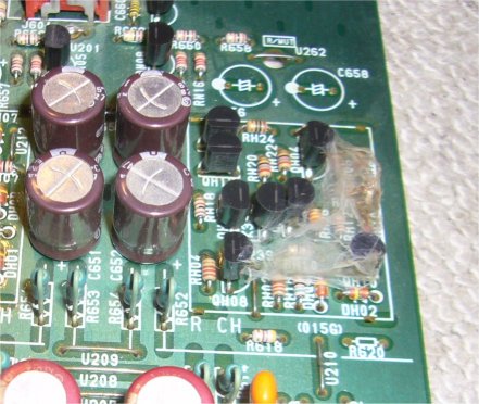

hotiron said:Ther be spiders under them HDAMS get rid of them at all costs
Hahaha, that's pretty cool!
All my life I have been finding bugs and spiders inside high end aparatus.rowemeister said:LOL
That's more common than you may think. I wonder what they are feeding on.
Maybe they like the sound waves.... maybe they feed on electron transfer....

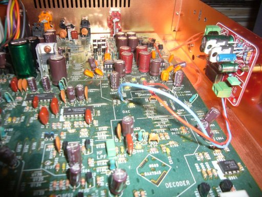

were do you connect the ground to, when using PowerRegs with there own PowerSupply
right now I have two 5v+ Regs on the DAC, 1 for Analogue, 1 for Digital. feeding power from the +10v in the Player
I have the Grounds of both Regs connected to the Grounds near the DAC
should I connect the Regs ground directly to the Analogue/Digital Ground Pins. do you still leave the Dac pins connected to the PCB if connecting directly
Eg for Analogue
+5vPOS - to Pin11 Vdda
-Ground - to Pin12 Vssa
That explains the muffled sound then. All the changes that I made and I just needed to get rid of the cobwebs!
You should create a star GND and route all the GND there.e1roy said:were do you connect the ground to, when using PowerRegs with there own PowerSupply

This makes a BIG improvement in all areas but particularly on the bass.
Search this thread for "star GND" and you will find all the answers.

IMO cobwebs have nothing to do with the muffled sound.
just use "propper opamps" and get rid of HDAM... then you will remove the muffling.

I have searched the Thread, found lots of info.
when you say "create a star GND and route all the GND there"
you mean all grounds from all SRegs and all grounds on the CD PCB
I understand that all SReg Grounds should connect to the StarGround (and possible to the Earth from IEC)
where do I link the StarGound to the RCA Ground?
Thanks appreciate your help
You've answered your own question. The star is just a point where all grounds go. The RCAs want a wire from them (as close to them as possible) to this new star point, as does the DAC, servo chip, decoder chip, super regs, other regs... etc
The next step would be to cut the original grounds, but don't do this until you have a very good understanding of what you're doing.
Simon
im my case, I created a Star GND and connected it to the GND under C804 (That I removed).
You can connect it to the GND near the output RCA´s.
Then all GND from all the aditional regs and Psu go to the star GND.
You can connect this GND to Earth GND but I believe that it is not very important.
The star GND concept comes from the tube amps that need a star gnd to avoid GND loops.
You will notice a big improvement in bass and also a total absence of hum and noise.
Ricardo
