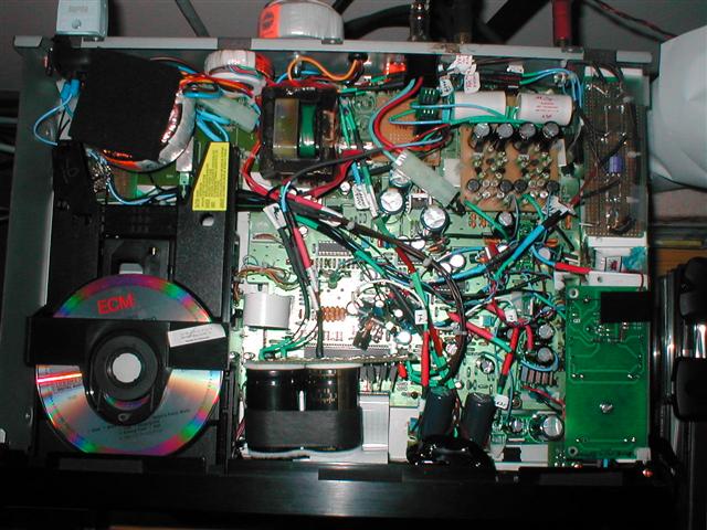

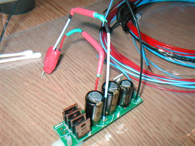

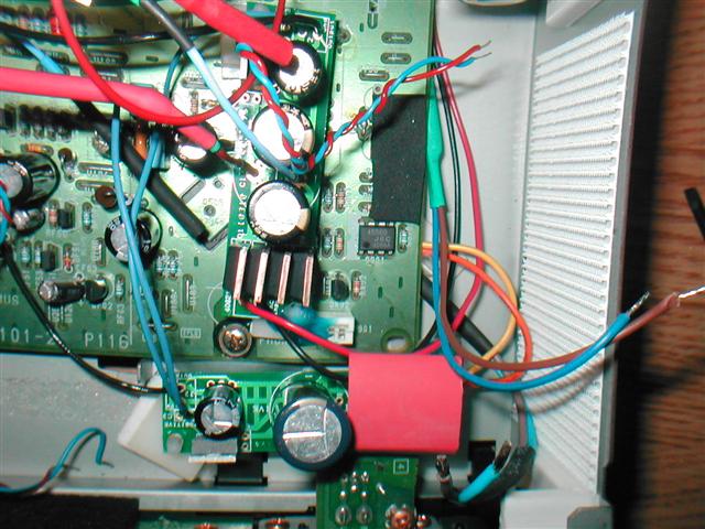

I just finished and installed a decoder psu. After a long study and the input I received from all of you, here are my final choices:
2x9V 7VA TX
4x hexfred + 2200uF Pana FC + LM340AT-5 for the digital rails Pin 15 and 44. (this one decoupled with a 220uF ZA)
4x hexfred + 2 x 470uF BG std + 2x LM340AT-5, (one reg for pin 11 decoupled with a 220uF BG std and the other reg for the HF/RF on R505 also decoupled with a 220uF BG std on C504)
I used Brent´s wonderfull psu pcb´s.... this made everything faster and fuss free.
I must wait for everything to settle but I can already hear some very important changes: Attack on acoustic string instruments like guitar or bass is much faster.
I can now hear more detail in the metal dishes of the drums.
Bass is fullbodyied and powerfull but with more edge attack.
Hope the burning will integrate everything again and bring female voice back to normal sweet state (now a bit edgy).
But the best difference is in the size of the soundstage... now it is almost on par with the TT. (I believe that the subliminar high freq info, now aparent, helps a lot in recreating a vivid, focused and life size sound presentation.) (Simon - as usual you were right).
Once more I did it succefully at first time...😀 I seem to be getting good at this...

Here are some pics:
Luke said:I might try some. Thats a nice board, are the to220 packages rectifiers?
Yes TO220.
You must choose the LM340 (AT) version.
Much better ripple rejection.... of course I am saving for some spowers.... but that´s another story.

RCruz said:Final overview:
6 TX (9 independent psu´s)
12 regs (3 spowers + 3 srayregs + 5 LM340AT + 1 stock 79M18)
2 x clocks (Dac and Servo)
Sound is awesome![]()

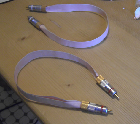

I treated my CD63 to a new interconnect I knocked up yesterday (took aaages).
Oh, it's good, beating my previous copper one and maybe even beating these solid cu connectors & Kimber 4TC we tried!
