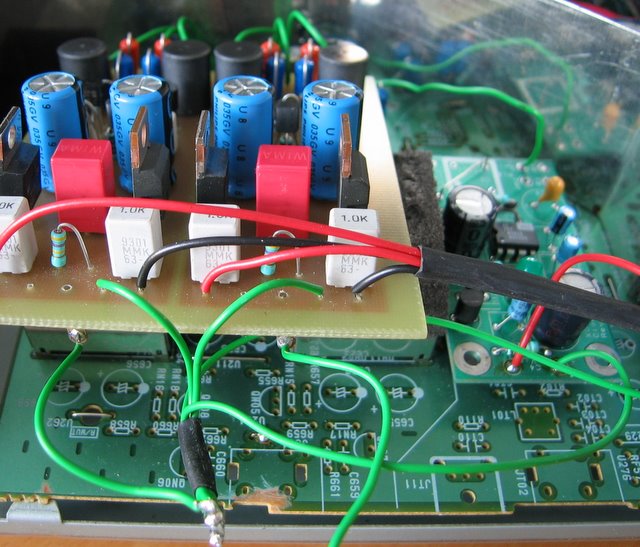

Re: Re: Re: Re: Re: Re: A minor update
RCruz said:
It makes sense to me.... and it seems easy to implement also.
Of course you will need a separate psu for this modd.....
One question remains... do you or do you not connect the GND of your discrete board to the GND in the player ?
Ricardo
GND of the discrete goes to GND of it's PSU - and on to the AGND. As a matter of fact I let the U197 & U198 enter the discrete board at it's input end and connects the grounds (left and right) at output end of the discrete to the RCA's.
This picture illustrates it. 3 wires in at input end, LO, LON and U198 (RO, RON and U197) and 2 GND wires at output end + Flea GND + analog PSU GND.
Don't get confused over the LR outputs from the discrete.
Re: Re: Re: Re: Re: Re: Re: A minor update
Are your RCA´s isolated from the player (no gnd contact)?
Do you connect your analog psu GND to mains earth ?
Splendid work.
Ricardo
Re: Re: Re: Re: Re: Re: Re: Re: A minor update
Splendid work.
Ricardo
1. Yes, isolated.
2. Main earth - do you mean protective ground? You could, but why ? You don't need to.
(I have connected mine to my own separate earth rod exclusive for my audio) - but pls. be careful - understand the potential of 230V, groundloops and shock hazard.
Re: Re: Re: Re: Re: Re: Re: Re: Re: A minor update
avr300 said:
1. Yes, isolated.
So in reality you have two separate PSU in the player...
1 - Psu Digital + GND on the main PCB
2 - Psu Analog for the dac and output discrete + One common AGND.....
And you do not connect both GND ever.
I never tried it because I believed some kind of (gnd leverage) was needed to make things work.
This is a major modd.
The sound must be so much better...:hot:
Very impressed.
