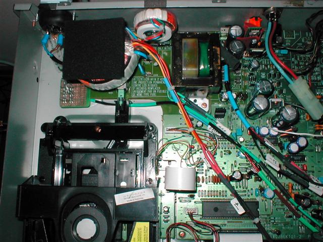

Look at my latest mods list and you will see where I have put the coax. I also cut the track underneath so the signal only travels through the coax.
The coax mods are for the RF signal and clock lines from dac to decoder etc. It eliminates all the tracks that carry these signals thus removing noise passed on and also received.
The first one to do is the RF signal from RF pcb to decoder ic. It adds a little more control and detail to proceedings a little like adding a clock.
Using coax, I believe I must wire it as it was carrying analog signal so I must ground the external mesh to ground only on one side of the wire.
Normally, the ground is made on the end where the signal enters the cable (In my turntable, the ground is on the pickup end so there is no ground on the preamp end).
In this case where should I ground the mesh on the RF pcb side ?

You a right only using one end of the coax connected to gnd. The source end for the RF is on the mech pcb.

Very nice Brentrowemeister said:
Any particular reason to use this Kimber coax ?
Is it good to work with ?
Hope you can give us a feedback on the sound improvements.
Ricardo

I have run the cd with just the coax fitted today and finished off with the FKs late on. I have left the cd at work as I did not have time to put it all back together.
I did notice an improvement in the crispness and clarity of the treble with the coax upgrade
Brent

I already had the Kimber lead so decided to use it. It uses high purity copper with better insulation material. It is actually harder to work with than the other coax I used as it is a bit thicker.
