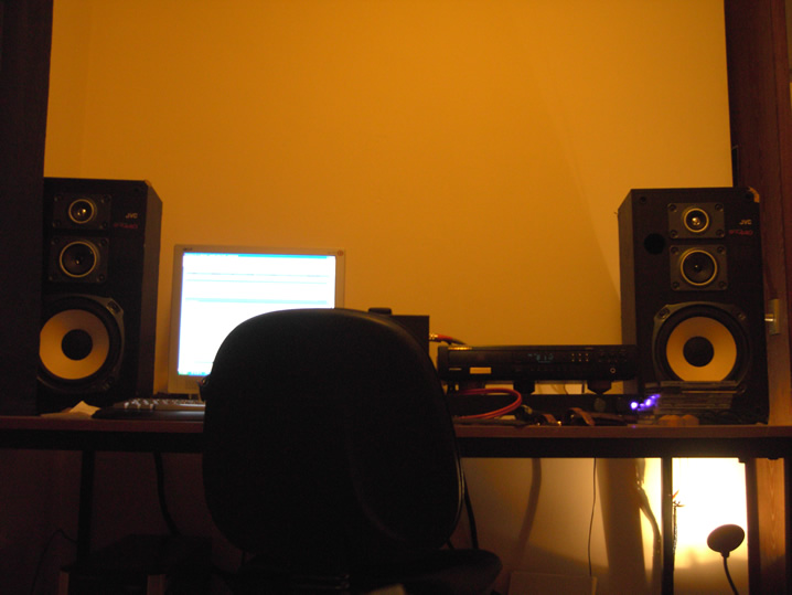

Haha, I want in on this FK action now! :wave2:
But it'll have to wait till I'm listening through headphones more or better speakers so I can hear what's happening.
These 3-way JVCs don't quite have the resolving abilities of my DIY set that I've had to lend out due to being in a small room now..
