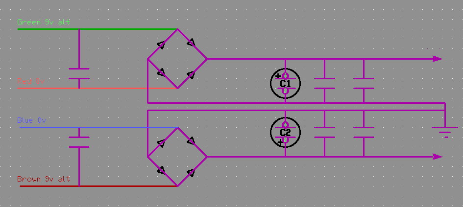

I want to power the servo with two sregs .
Can I use this tech here ?
I am afraid I might cause some ground loops.
Ricardo
rowemeister said:
they are all ground. But the chip has a gnd to match the digital and a ground to match the analogue rails. In most circumstances the grounds are all connected together. It is always best to keep the supply and its relevent ground equal length if possible.
Thank you Brent
I already have a PSU layout for the two +5v sregs.
As I am using one Nuvotem 5VA with two 9v secondaries, I believe I could use the layout in attach.
Note:
Each "arrow" should have +5v regardind to GND.
Ricardo
