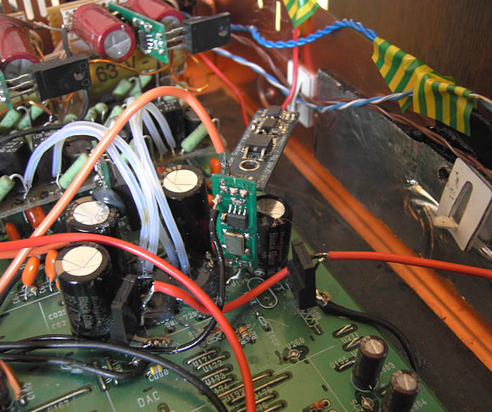

Brent - got a C1 for Xmas!!
Hi Brent,
Glad to see you active on here again.
My wife, bless her, surprised me with a C1 master clock for Christmas
(and there was I thinking she was fed up of me spending hours hunched over the dead remains of my original KI and the laptop wading through this thread and PFM until the wee small hours!!)
My question is this. Among my Rayregs I also have an Audiocom superreg (the £17 eBay ones similar size to the clock PCB.)
Iwas thinking of connecting it directly on to the clock pcb near the top.
Should I do this to keep the traces as short as possible?
Also I am going to put in the divide by 2 circuit to reclock the servo, so should the divider have its own reg, or would the same supply be OK?
I don't want to cause any grounding issues.
Cheers
Jim

jimh0612 said:If I wanted to use the RJH's on the opamps would the 470u/63v be slower sounding at all instead of the 16 or 25v versions?
Hi Jim,
I can't think why that would be the case. The 63V versions may have a lower ESR, which is a good thing. There may be some argument for not using caps so overrated, but I really don't think you should spend a moment longer thinking about it.
Simon
Perhaps this - increased voltage rating = increase physical size = increased inductance
Re: Brent - got a C1 for Xmas!!
You mean like this? 😉 Yes, do it! 😀
jimh0612 said:My question is this. Among my Rayregs I also have an Audiocom superreg (the £17 eBay ones similar size to the clock PCB.)
JonHarrison said:Perhaps this - increased voltage rating = increase physical size = increased inductance
Ok. Jim, try to get a technical datasheet for the capacitors and look for two figures: ESR and ESL. Effective Series Resistance and Effective Series Inductance. These largely determine the perceived sound quality. Lower = better.
Re: Re: Brent - got a C1 for Xmas!!
I'm glad that's not my player...😉
SimontY said:You mean like this? 😉 Yes, do it! 😀
