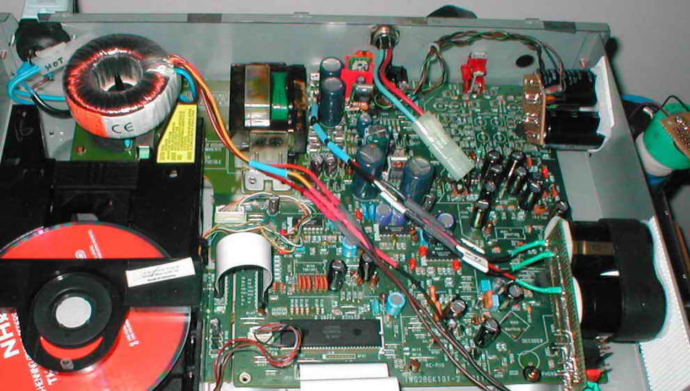

Malefoda said:
As you may know I've fitted a Super Regulator, from Sercal aka Brent, in the best CD53 of the world (yes I have no competitors for you are all with 63/67 😉 ).
Here is the pictures of the player at the moment.
The SReg 5V is powered via C813.
Hi Matthieu
I am also modding a CD53 and am very interested in your work.
I examined your photo but did not identify the Sreg.
Can you please explain more ?
What type of clock are you using ?
Regards
Ricardo

Just a quick pic to show progress so far.
Wires still to be tidied and still 2x2200uF 35v BG FK to be added onto legs of S-Powers on the rear panel. But I'm struggling to think of anything else to do. Any ideas welcome.
Lee.

Hi Ricardo, the Sreg is just in front of the BG at the opamps. It's the small PCB wich I managed to make it look as stock as possible. I think it does look OEM 😉 I feel bad with war in my CDP. The Clock is the famous Flea, you can find more about it at Pink Fish Media forums. It has its own PSU. Beside the full Ray's list (wich is a big work!) I've the clock and its PSU, Raygulators for the opamps, BG@LM4562, HF coax mod, damping and cooling on chassis... now it's a so great player! I just hope I'm near the CDP I was near to buy, the Naim CD5i and for this that all the work done is justified. Unfortunately I've no Naim to face :'(

Hi Ricardo, the Sreg is just in front of the BG at the opamps. It's the small PCB wich I managed to make it look as stock as possible. I think it does look OEM 😉 I feel bad with war in my CDP. The Clock is the famous Flea, you can find more about it at Pink Fish Media forums. It has its own PSU. Beside the full Ray's list (wich is a big work!) I've the clock and its PSU, Raygulators for the opamps, BG@LM4562.
Thank you Matthieu
Your work is superb !!!
I have done similar mods in my CD53 and want to upgrade with a clock in the servo and dac.
Also love the micas you placed around the opamps... I will do that also.
I recently upgraded my analog PSU with a 30VA TX and the result is a much bigger sounstage with good bass and definition.
I did not find a way to post pictures (mine seem to be too big) but will find out soon.
Regards
Ricardo
