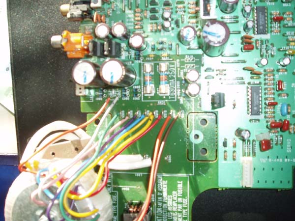

Are you going to supply the pcb's for us to butcher ourselves? LOL
I have my original KI which I managed to bu**er up and asked you about months ago.
Couldn't figure it out then so got a cheap SE off eBay and been modding that.
Going to either
1) Put the SE PCB in the KI with KI tranny until I get all the separate trannies sorted out like yours.
2) Try and get the KI working or failing that
3) Send the KI pcb to some bloke in Doncaster who might be able to perform miracles!!
It's probably something dead simple but it was beyond me when I first started.
One thing puzzles me though. The voltages from the trannies are all the same except at U307. The SE reads 16.5v and the KI 33.6v. The KI transformer has two yellow leads going to U307. Is this reght for a KI do you think?
JIm

Yes the discrete pcb will go on sale to get butchered
A bloke in donny hey wonder who that is LOL
All the voltages should be the same! that 33.6 is double the 16.5V.
Did you take any pics of where the original wires went on the KI?
Take a piccy of the wiring you have done and post it on here so we can check it out.
The Yellow leads should go to U309
Brent

Hi Brent
Yeh dunno who the bloke in Donny is but he doesn't seem to get a lot of work done tinkering with CDP's all day!! LOL
Been trying to insert an image but think I need hosting?? to do that.
Have emailed instead.
I haven't moved the TX yet.
All I've done is reattach the orange lead at C801 when I thought it had come away.
Thought the voltage was wrong when I checked it against the SE.
Rgds
Jim

Solder blob under U309 to star shaped ground under U274.
Dunno if I've blown something inside the TX.
I did have a mishap when the tranny moved while the CDP was powered up and the mounting bracket may have shorted something.
I had attached an earth to the IEC socket which also slipped and shorted to the live at JH02.
And me a builder - I work with electrics all the time. (PI**OCK!!)
(Sheepish) Jim
(Sheepish) Jim
jimh0612 said:Grey wire at C802.
C801 and C802 are unpopulated.
Not very good at following service manual schematics I'm afraid.
Jim
The Orange and gray wires are not shown in the service manual as they are connected internally of the tx on the 63 and SE
Brent
