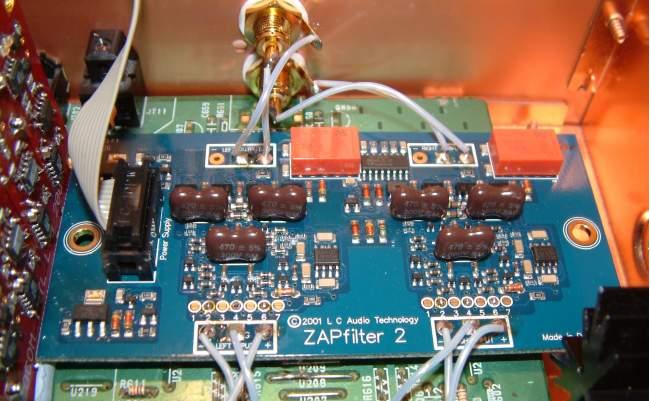

Well after letting the player settle for over a week on continuous repeat the player has taken on a whole new lease of life
When I first installed the Zapfilter 2 output stage the player sounded ultra detailed but uninvolving. Now it still has all the micro detail as before but the whole sound has opened up, the sound stage is huge and vocals sound as if they are in the room!
Next step is to mount the Zapfilters PSU in a separate enclosure and add another transformer for the servo regs
The only problem I now have is yet another dodgy laser from Grandata
Mags.

Hi Brent.
When I used to mod these players for other people I never had a problem with Grandata but the last 2 laser I've got form them seem to have a different Vam1202 sticker on them? Luckily I have a spare CD63KI and CD67SE (slightly modded) with good CDM12.1 lasers and a VAM1202 from Dalbani. The 1 in my player jumps even on new disc's and will not read CDR's
Mags.

Do these new units need adjustment?Mags said:... the last 2 laser I've got form them seem to have a different Vam1202 sticker on them? ... The 1 in my player jumps even on new disc's and will not read CDR's
Seems that way. Bad QC.
Brent's old trick of adjusting the glued bolts on the underside was necessary for my VAM1202 to play CDRs. Maybe it's to do with disc thickness which may affect focussing, but my blanks are mainly Plextor made by Taiyo Yuden which are supposed to be the best.
Adjust too far and it stops playing some normal discs!
The art is to find the sweet spot where it plays everything.
I had a couple of especially tricky CDRs and one tricky normal CD that provided the boundaries. At the sweet spot it plays everything.
I found that adjustment to one of the bolts was not sufficient and I had to adjust them both.
Major pain but once done it has been playing fine for months.
