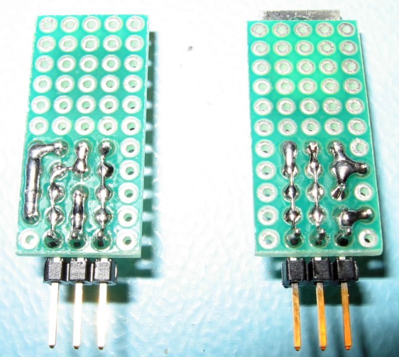

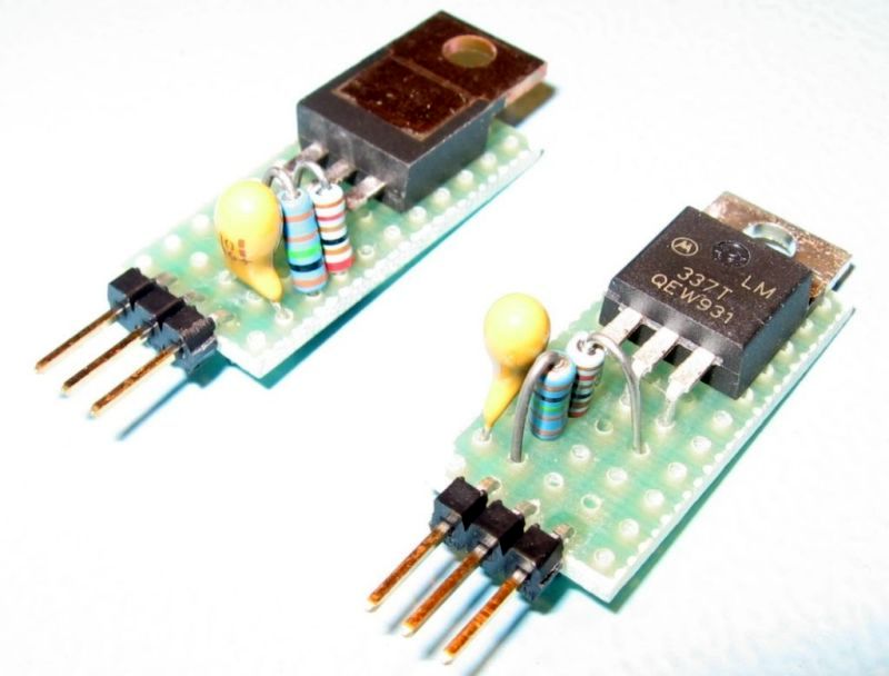

My lm337 regs...
Front and back shots should be right i guess. the positive side of the tants are facing down, joining r2(the second resistor to the gnd pin(left most pin of LM337)
Can someone give me some heads up on the regs, so that i can start making a few more for the DAC section. Just want to be on the safe side.
Can i check what will happened if there were to be any error in the regs? will the cdp go dead..?

hmm.. how do i check the output voltage
To check the output voltage:
connect the voltage in to wherever you are taking the input voltage from
connect the regs ground to a ground connection on the pcb. Do not connect the regs output to the cd player!
Connect your multimeter's red lead to the regs output and the black lead to ground and select the dc setting.
Power on, but first make sure that the regs output is not connected to the cd player! Hopefully you will get the reading you want! It should be a negative voltage, LM337 is a negative voltage regulator. Don't connect a negative supply around the dac as I am fairly sure this will ruin it.
