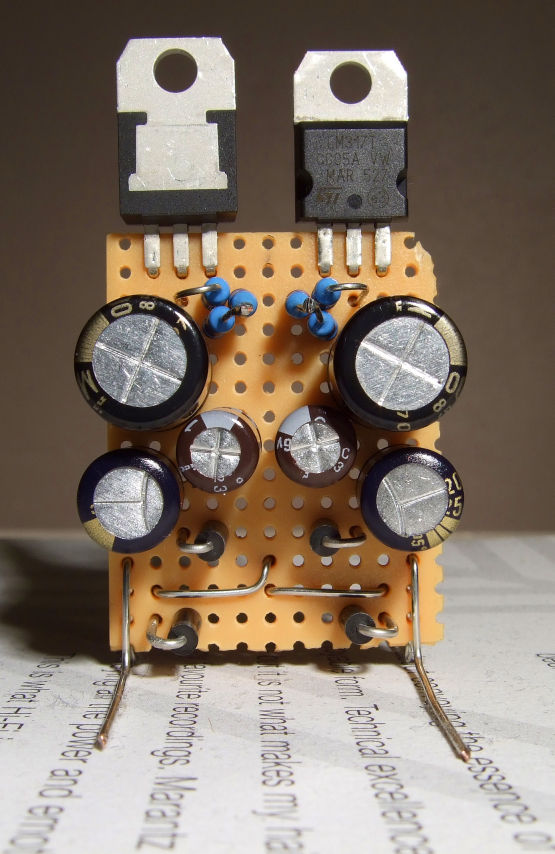

After reading this regarding grounds from tentlabs.com, maybe I should just tie analog outs from dac (pins 19 and 24) to the ground plane under the dac? Now they don't tie to the ground plane until 10cm later, next to the RCA output jacks. It seems the designers had a reason, but...
My question about two grounds for the 5v reg still stands! I'm about to say screw it and tie them together like I didn't know better!

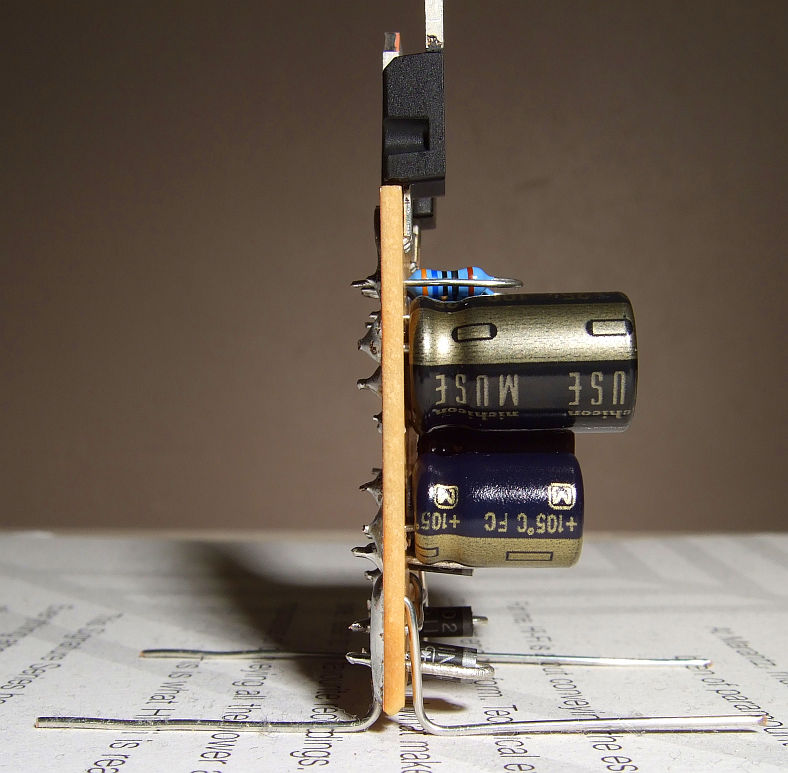

How about two regs? One for left and one for right. That's what I did. I had to cut a track to separate them.
I have an input wire to the middle track, decoupling grounds soldered to ground plane, output and adjust grounds to dac pins.
If you're just having the one reg, I'd suggest just connecting both grounds (decoupling and sense) together and to the ground plane. The load is still decoupled to the analogue grounds at the DAC itself.
P.S. - I know I should've used LEDs or zeners but I just used what I had handy. I only bothered with the protection diodes because I had some 1N4002 and there was room.🙂

Now I see why you are called glenn2 (two in one!) Nice. 😀
I think I'll copy that, although I do have a few green LEDs to put in, thanks Martin. (...1/5 to 1/8 of the noise!)
Where exactly are you attaching those nicely spaced legs?
BTW- With the board out and no power, I'm getting 0 ohms between u199 (+5v analog at dac) and ground plane. Is that normal? It seems like a short, but I never checked it before...

Joe-HT said:Where exactly are you attaching those nicely spaced legs?
Well you may have to mount it sideways to right of the DAC. I mounted it between where the op-amps used to be (where the decoupling caps were) as I have removed the analogue stage and replaced it with an LC Audio Zapfilter2.
You could just put four in a row, for your four DAC supplies.
