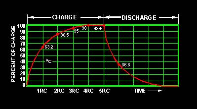

Presumably tweaking this power-on reset circuit would be your solution? Part PST994D.
The time constant (to charge the cap to 63.2%) is 0.47 seconds.
The threshold is 4.2V which is 84% and it will take longer to reach this. Say 1 second. Increasing R or C should increase this window the system has to stabilise.
Try increasing CF03 from 4.7uF to 10uF to double this period, or 22uF to really make sure. I know it's a 63V part but they would only use that for convenience. It can only charge to 5V.
