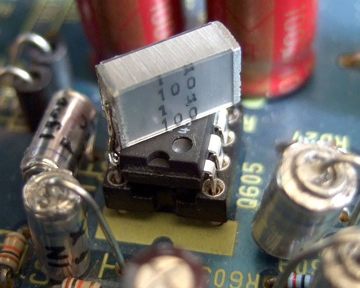

Can I break in here and ask two questions? One: in anyone's experience, how long do the LM4562's take to run in? (I am past the 100hr mark and I think they are still changing) Two: maybe Brent has the answer. I want to by-pass the ops with some caps on the board (under) Malefedo sent me some Wima's (1uF 63etc.) but the leads were too short. The only supplier I found was Farnell, and I don't think they will sell just 2!) Is there a good alternative? where?

Thanks Glenn! The picture is confusing though. It shows u33, which the discription is for 1uf. I guess this is newbie ignorance!?
Better than the Wima? Soldering on the chip legs is scary...no danger of over-heating? Regarding the opamps. Are you the one who found them mechanical as apposed to musical sounding? If so, you were right...but this changes slowly over time. I would like to think they are still burning in😉 I don't know what the caps are supposed to do. I just follow blindly were you guys lead! So far so good! Give me ten more years and I'll be one of the "old masters" initiating the new comers to the longest thread in history (fat chance!) ps I can't see where the other leg goes. Is this the same as using plot 2 and 8 underneath?

shepperd said:Thanks Glenn! The picture is confusing though. It shows u33, which the discription is for 1uf. I guess this is newbie ignorance!?
They use the same picture for the whole range, that's all.
I wouldn't say these are better as I haven't tried Wimas in this position.
These caps are great at keeping fast op-amps stable, although the LM4562 should be OK without, and maybe these are overkill.
Makes a big difference on LM6172, AD826, AD8065/6 and LT1364 which are all faster chips.
The LM4562 also has spectacular PSRR (power supply rejection ratio) so maybe no cap is best. The only way to know is to try but with this chip I'm not sure you'll hear much of an effect. Others here can comment better because they use this chip.
What the cap does is provide a path around the op-amp for high-frequency noise. You may leak noise from one rail to the other but if the noise is on both rails in equal measure it won't go through the op-amp anyway.
Oh, pins 4 and 8 on a dual op-amp.
I did find them unmusical (and I wasn't the only one) but I'm notoriously impatient. I gave them a few days and yanked them out. What was missing became obvious when it came back (when I put in an AD825 module, though these can sound coarse).
