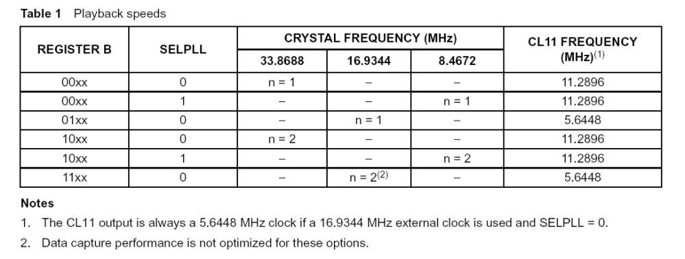

Martin - is this interesting? See note 1. We can't set the registers but we can SELPLL. Is this the 1/2speed bitclock one would need for a TDA1541A (if one could get one)?
Just checked the CD67 schematic.
If you disconnected the NPC dac, clocked the Servo/decoder at 16.9Mhz, you'd get I2S out and 5.65Mhz from CL11 by default as SELPLL is held low. CL11 is just sitting there unconnected.
If I'm right then this would drive a TDA1541A (with suitable supplies) of course.
