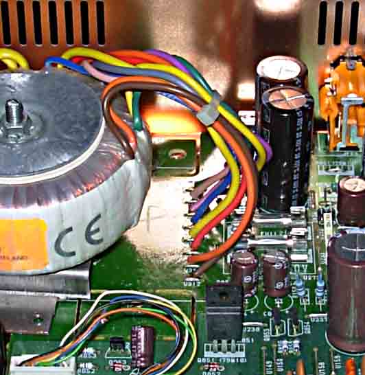

Thomo said:
Hi. Did you compare with the KI to ensure you connected the toroid wires correctly?
If not, I have attached a pic which may help (it's a bit low qual tho'). Check fuses also.
Lee.
Thomo(or anybody),
you'd make me so happy with this pic in somewhat higher resolution.
(I've a brown wire coming out of the TX, can't see it on the pic?)
I marked the order in which the wires came of the KI TX, but this looks different? 🙄
This is the best I can do....
Also, there are a couple of links on the board before the toroid. You should defo check these to make sure they match the ki board.
I THINK I removed u247 & added u248. u249 should be in as should: u242 to u246.
Just compare the boards closely...
Lee.
Lee.
Thanks a lot, this picture is quite clear (although it seems to be of another player?) Several colors differ but all the different windings (and therefore voltages) are the same.
I've checked al links between the 220 connexion and the TX, they are the same, I measure 220 volts at the TX I've also checked the two fuses, measure 9 volts at both sides of 'em.
* I still measure arround 29 volts at U311 and U312, can anybody confirm that this is correct, or?
* At which other points can / should I meassure voltages to check?
Please help me out, I miss my music :bawling:
Check for AC between those two points. They are the VFD heater supply. Check D851, D852 and D854. (Short=dead.) Try to measure what's going into Q851 and coming out. (7918 reg). There should be about 24-25v coming out as there is a 6.8v zener lifting it from gnd. Careful not to short anything and blow up that nice TX!
The voltages coming out of that winding (if properly connected) should be 3.5VAC, floating at -19.6VDC. You have to be clear about what you're measuring.
If you've checked the fuses for the 5V lines are intact, what AC do you get between the two? If it's not around about 9.3V, take out BOTH fuses and measure again for the unloaded figure.
What do you get going into the op-amps?
The AC and pre-regulated DC voltages in the service manual are a guide based on the basic bog-standard transformer, not KI toroid. They may be a bit different, and also vary for someone on 220V compared to 240V, etc... The only important thing is that they are not too low as prevent regulation and not too high as to overheat the regs, VFD etc.
Good luck!
