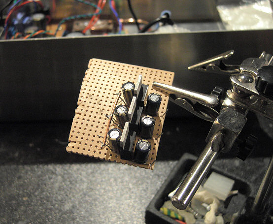

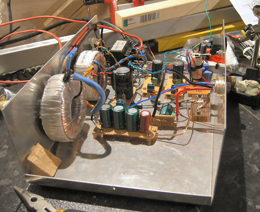

Hi everyone,
I finished my next mod (as recently described), which was to feed each of my 5v regulators with it's own power supply.
One toroid winding feeds DAC/decoder digital, the same toroid's other winding feeds the DAC clock reference pin.
An additional, fairly large (probably 70va+) toroid is dedicated to DAC/decoder analogue. This transformer is centre-tapped so I only used two diodes to rectify the power (this halves the total available voltage but provides more current, I think). This one is smoothed by 3 x 1000u Nichicon MUSE, then 220u Cerafine. Then in the player there's 33u Pana Fc before and after the reg. Then locally, at the DAC, there's a 470u Black Gate. Overkill? 😉
I have gained what can only be described as a weighty, solid sound. Tha bass bounces along with force and tunefulness. Similar improvements to when I added a transformer for the 5v rails previously. The timing is great. It's getting a bit like vinyl I reckon, only without the crackles. :whazzat:
Simon

Here's my new little reg board. I should probably run each earth to the star separately, but I have joined them for the time being, to save time! I will eventually place a super reg (Audiocom or Brent's) on the digital and anologue lines, but probably not the clock reference. One needs money for such perfection...

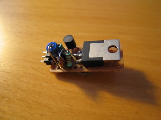

Hello most helpful people,
I've built 3 Super-Raygulators, but I'm having a problem with the output voltage (but at least I'm getting something 🙂).
I'm trying to get a 5V output, so I'm using 3.3V Zeners and the recommended diode. I should be getting 1.25+3.3+0.7 = 4.95V, but I'm only getting 4.27V (measured across ground and output. Is that the right spot?).
I went and got some 3.9V Zeners and installed them and now I'm getting 4.72V
First question (if you ignore the one above in brackets 🙂) will this output be sufficient, or do I need to get closer to 5V.
Second question if 4.72V isn't enough, the next step up for Zeners is 4.7V, which will probably the output voltage too high, so the other option is to change the 1N4148. My calculation is that I would need one with a 1V throughput. What is an appropriate part # to do that?
Below is a schematic that I drew up for component locations on the pcb. Can you tell me if I've done it wrong? (The blue wire runs across the back of the board.)

Diagram looks right at first glance.
Looking at your voltages, I would change the 1N4148. It may be short-circuit.
Andy

Check the orientation of the diodes. You have to be able to hit 4.97v with the specified components.
Also check the orientation of the transistor. Compared to my reg. your transistor is 180 degrees off - but that can by due to the way you have build yours.

Thanks for the reply guys.
I used this datasheet
http://www.ortodoxism.ro/datasheets/philips/BC546_547_3.pdf
for the transistor and it shows pin 1 going to the LM317 input, then I saw another data sheet with the pins the other way around :devilr:.
Anyway, I flipped the transistor around.
I'm still getting about 4.8V.
I've measured the 3.9V Zeners and they read 2.9 V with the circuit connected. The 1N4148 reads just over 0.7V which they should. The 2 zeners and the normal diode are pointing away from each other visually and they measure that way too.
why have you shown two diodes in parallel?
Is that the way you installed them?
you only need one diode to adjust the zener to near your required voltage.
A zener reading 1volt under rating is either mislabelled or drawing FAR TOO LITTLE current. A red LED would be much quieter, try to find two LEDs in series that give 3.75V (maybe a red + green or two orange).
YoungSC, simplify your circuit by leaving out the gyrator (the transistor, C1 and R1) until you have a stable and usable reg.
I also have seen datasheeds saying BC547 should orientate "the wrong way", but I stick to my childhood learning. Flat side to the left, seen from the top, then you have CBE top-down.
http://www.fairchildsemi.com/ds/BC/BC547.pdf
BTW- what is your feeding voltage ?
edit - YoungSC - Andrew might have said it, your running it 5v. :smash: The zeners are drawing to little current. Try the LED trick.
