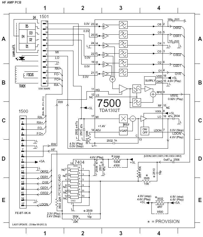

cd6000 skipping
Hi Andy,
I had a good look and did what you suggest. Degreasing did nothing and I resoldered the HF connector (thats the white plastic ribbon connector) any continuity test is quite good.
I Dont want to touch my cd67 cos Ive neverdone lasers so i dont want to risk loosing both players. Do you know what laser I need and are there any good places to buy these things online?

The laser's a CDM12.1 in the 63/67 but that was superceded by VAM1201 then VAM1202 and I don't know what they used in the '6000 but it will certainly be one of them. They are backwards compatible. I successfully inserted a VAM1202 in a CD63 a few years back and have one in reserve for when my CD67SE goes. They are also mercifully cheap. I paid about £18 from Grandata so try them if you can't find an NZ supplier.
EDIT: they list it as CDM12.1 mech but it's a VAM1202 that they send you.
EDIT2: you could try inserting 'provisional' capacitor 2509 on the HF amp PCB (10pf) - see service manual. This reportedly cures the problem some CD6000's have when moving from track to track on CDRs. You never know and it's easy to try. You don't need an SMD part, just solder any old 10pF ceramic disc in and see if it helps.

Hi Arthur,
Here's a page that describes the laser replacement for these players. Maybe it can be of help.
Ray

Thanks for you link, I will ring the local guys on Monday and if they cant get me one at a competive price Ill order from Grandata. I will also do the mod even thought I dont think this sounds like my problem.
Ray nice link, I think Id have to try real hard to break anything with instructions that good, but hey if any one can.....
