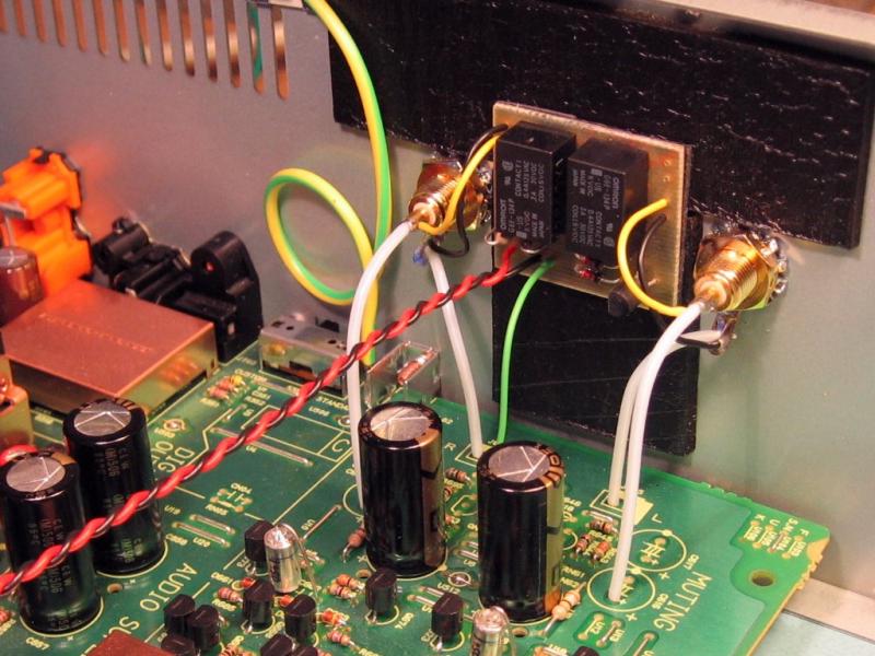

b.t.w put my 4562's in yesterday, my 5V reg board today, and also my new RCA sockets. With a brief listen of imogen heaps - imegaphone, special japanese release it sounds very nice, but i only go the cd yesterday 😀
The result of a few hours hard labour: a new muting relay!
(and some silver wiring 😀)
