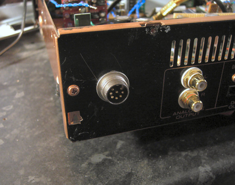

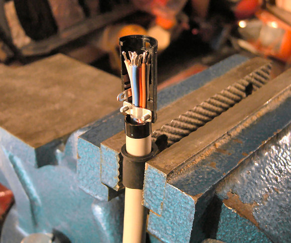

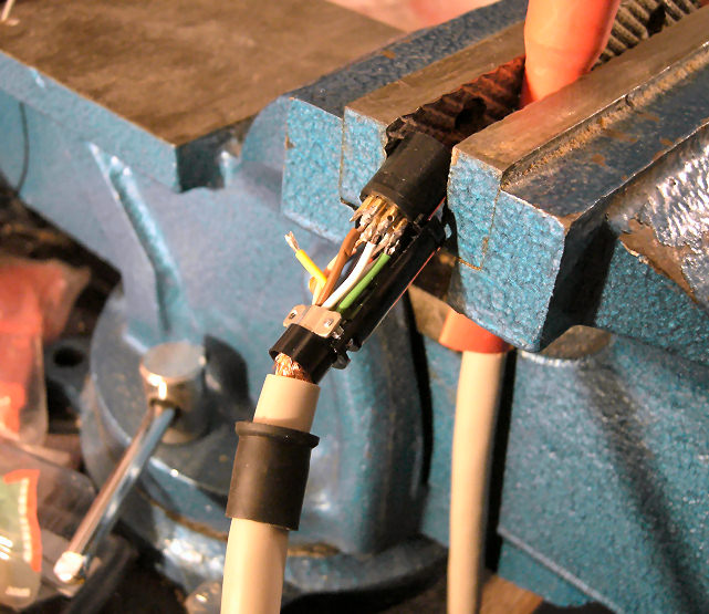

SimontY said:The "Lapp Kabel" 8 core wire is very nice. Copper braid shielded and eight distinct colours of insulation. Stranded copper. It only just squeezes into the DIN connector.
Is that your penis stuck in the vice. LOL

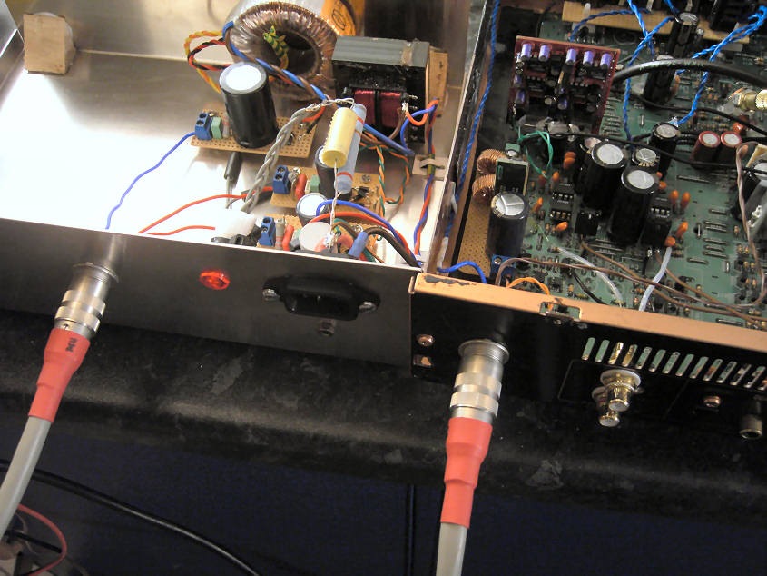

SimontY said:Did my psu connectors tonight 😀
Hey Simon!
Nice pictures, looks very neat. Nice connector job! I guess i'm falling behind, since my players still use the internal PSU 😀. Maybe i'm going to make one with tubes

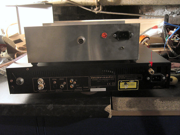

SimontY said:The red arrow points to the single grounding terminal. If this was disconnected all hell would break loose, as it's the only earth connection to the external psu (to avoid ground loops)...
Sorry for so many pictures. I guess I'm over excited!
Simon
LOL would be interesting if that fell out. Looking good though.
Brent
AndrewT said:Hi Simon, this sounds like you have the chassis safety earth connected to the audio ground. Am I interpreting that correctly?
It's as discussed previously. To recap: the CD and CD chassis are connected to safety earth, CD has star ground point.
The PS is "disconnected" from safety earth via 8.2/22nF but the chassis is directly connected for safety and shielding. PS also has a star ground point.
The two stars are connected via the binding post on CD end and hard wired at PS end (soon to add isolated binding post, I didn't want to drill at 12.30am).
I hope it's clear now. It's not such a simple machine anymore! lol
Simon
rowemeister said:LOL would be interesting if that fell out. Looking good though.
Brent
It sure would be
Yeh, thanks mate, I'm really pleased with how it's working out.
