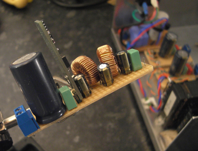

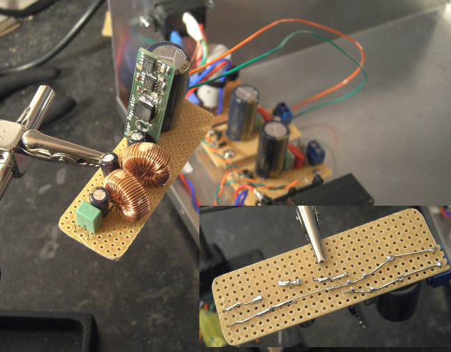

Good evening all,
I just made this to go in my player to feed the clock, it's 2200uF Pana FC, 1uF film, 12v Audiocom Super-reg, 33uF FC, 0.1mH, 33uF, 0.1mH, 33uF, 1uF. It's fed from one of the psus as shown previously. It works, which is nice for a change. Just need to do the 5v one then I can have a listening test!!
Simon (getting slightly excited..)
Here's another shot, with an inset to show the back, to see how it's wired. The ferrite cored inductors/chokes measure 0.1mH on my basic LCR meter, and about 4ohms DCR on my good multimeter. I do hope they're appropriate. This clock psu is vastly more elaborate (and more expensive) than the current setup. Can't wait to hear what it will do!
