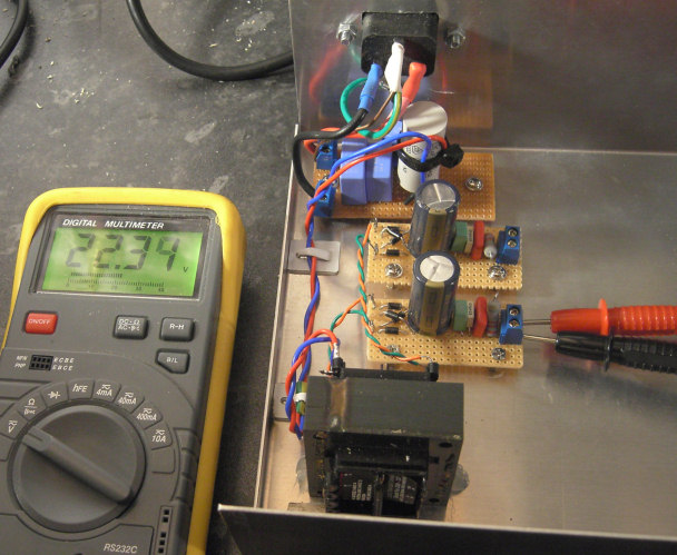

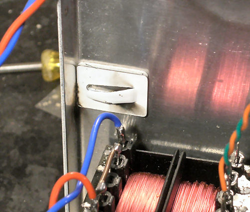

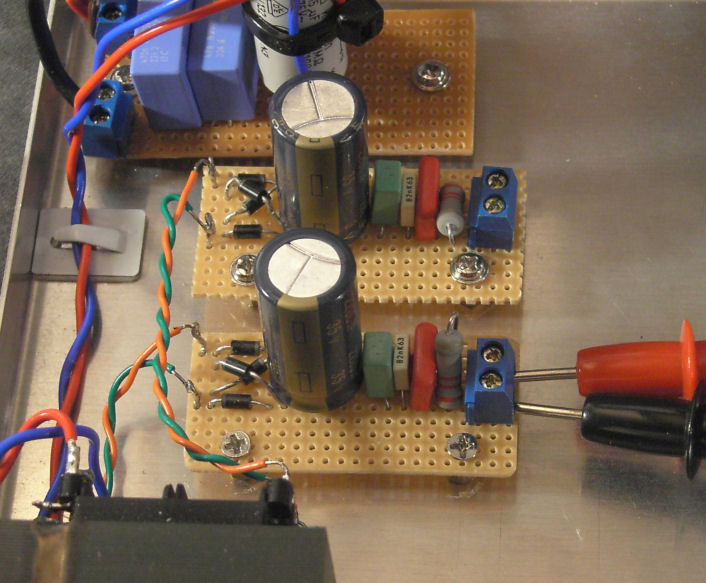

Here's a closeup. Apologies if this is too many pictures. I hope such pictures can help and inspire people to get their hands dirty, warm the soldering iron.
Of course this outputs roughly 22vdc... In the player, a further board (each) will provide additional smoothing, regulate the voltage to 12v for Audiocom clock (and 5v for divider circuit - only relevant in the CD63/53), and clean the power with additional filtering. I think I will have one "umbelical" connector for digital power, possibly using a 6-pin DIN and CAT5 network cable, to begin with.
If anyone would like to see additional pics to help them make a psu, just say so and I'll try to help. It's just about easy enough, but made easier by people's help.
