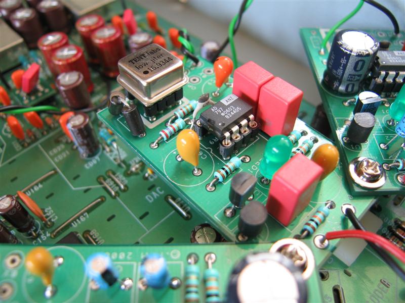

here is how it is now: just a big rubber around the xtal and grounded to a chassis screw.
In fact my listening conditions are varying a lot, according to my son, wife and open/closed doors... I've removed egg boxes 'coz we are about to move in our own house soon, wich has an empty and big room on the 2nd floor with a big space designed for music... 🙂
Ah, I see. Son eh? You're older than I pictured. Please don't take offence. :angel:
Right, I think U260 is ground, that'd be better to solder the can to - much neater and lower impedance/shorter wire.
Si

Malefoda
Do as Simon says and use the U260 connection. Also use lighter and thinner wire as thick ridgid wire may transfer vibrations to the xtal can.
Also it appears the crystal is on long legs. If so solder the crystal in as tight as possible. I find this is better. If its still not better remove the large rubber ring. If thats no good try a new crystal.
Brent
