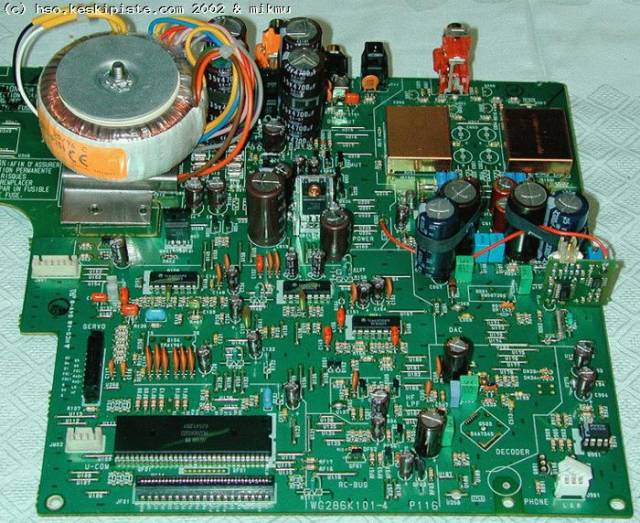

Aside from the present voltages there should be maybe three? extra 9VAC windings for separate powering of the DAC and clock. Could a 30VA be enough?
Ray.
For a KI it would be more sensible to use the original tranny and add a small one for separate supplies. But for the 63/67/SE/OSE it can be the same tranny.
We will need at least:
3x 9V for clock and DAC supplies??
1x 3,5V for display heaters
2x 9,6VCT for internal 5V and +/- 10V for drivers
2x 17,6VCT for +/-12V for opamps
1x 13,6V for display Vftd
These values are from the 63 schematics and the 67 will also run on that. Since most of the voltages are regulated, they can be rounded off to nice values.
