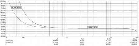

SimontY said:Hi guys!
My maths is rather poor and I couldn't quite work this out![]()
Could you help me choose a minimum cap value please? My pre-amps input impedance is 100K.
I hope to be using this discrete output in a couple of weeks or so lol (with FETs)
Thanks!
Simon
disco said:Simon,
Good choice, the fet buffer 😉
Maths come down to this simple eqation.
Take the outcome of the division of 1 by the result of the input impedance of your amp (in ohm) multiplied by the coupling cap (in Farad) multiplied by 6.28
So, f=1/(6.28 x 100000 x 0.0000033) = 0.48 Hz, which is low enough.

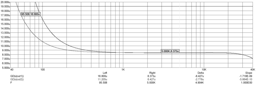

Hi guys,
That's all true, but......
there's also the low frequency group-delay that starts to act up when the signal frequency is at and below the -3dB point. I don't know how much harm that will do, because the low-end is less critical. But, just in case, to be sure, if you have some room to spare (and some bucks $$$) take a cap that's bigger.
How much bigger? I always like to calculate things 🙂. Well, you have to set some limits to determine the cap size. So I looked at the group-delay at 5kHz and though it would be nice to have a point in the low-end where the group delay would be no more than twice that value. Is that sane? I don't know. We're talking microseconds here at low frequencies. Maybe ten times that value? Or 1% of the frequency's period? Anyone?
To give you an idea how all this looks:
Both graphs are with 100k input impedance. The top graph is with 3u3 and the bottom one with a 10u output cap. The only problem is, at what frequency do we want this to happen??
Ray.

6h5c said:... there's also the low frequency group-delay that starts to act up when the signal frequency is at and below the -3dB point.
Hi Ray,
Interesting material. Delay is noticeable to the human hearing when larger then 50ms.
Looking at the graph I have trouble understanding the vertical axis. Is this time?
Regards, Jaap
disco said:Interesting material. Delay is noticeable to the human hearing when larger then 50ms.
It's group delay in micro seconds, not?
Well, the proof of the pudding etcetera...
Have two caps of the same brand and take a listen for differences. 😀
Regards, Jaap

Hi Ray,
That's an interesting graph but I for one won't be worrying about that tiny amount of delay. I'm sure my subwoofer is capable of causing problems 1000x more severe and audible. And then there are the crossovers.. Can't wait to hear your filter in action!
Simon
