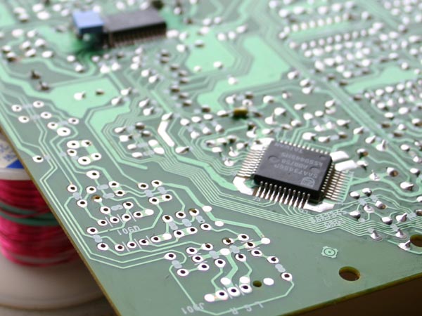

Noticed it this afternoon.
DOBM = pin 2 of IC SAA7345
Cut R514 in Decoder Section, just below U179.
Cut 5V supply by removing U221.
Regards, Jaap
disco said:
Noticed it this afternoon.![]()
Regards, Jaap

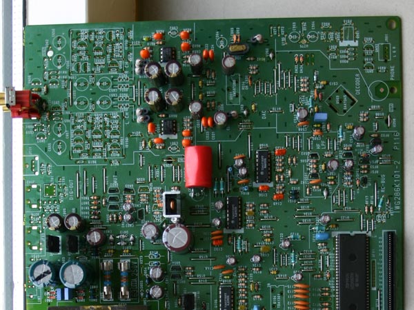

I need some space to upgrade the +12/-12V supply.
Now I had a look at the muting PSU (page 16) but it seems
connected to some trick circuit to do with VFTD (filements?).
Can I rip it out, or does it still have a function?
Regards, Jaap
Regards, Jaap
avr300 said:Better rip it out. Then you have space for yet another supereg.

disco said:Like this!
standard rca socket?
i thought you would have changed that by now
allan
