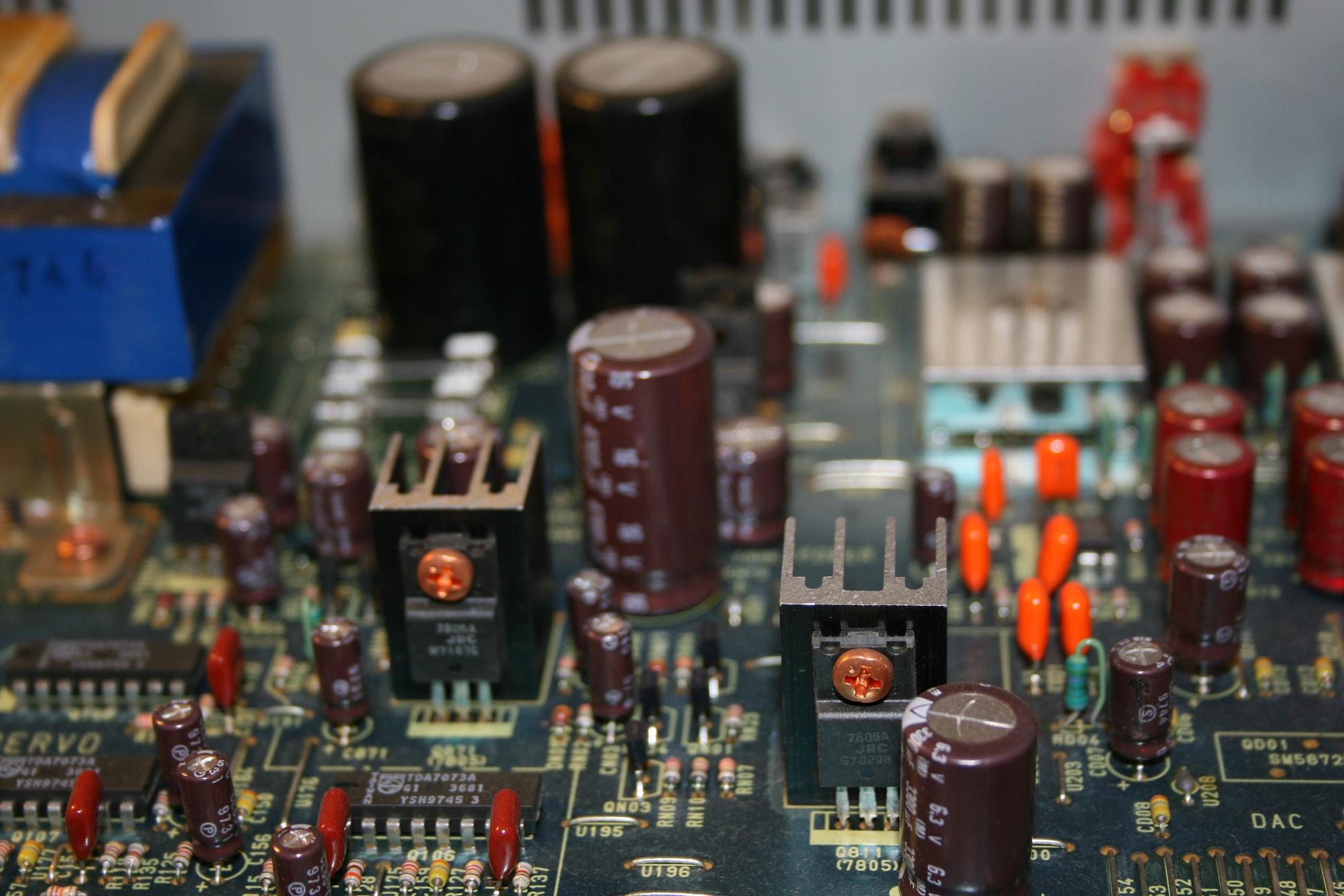

Voltage Regulators are cheap and they will gain a good improvement.
I.m.h.o. the highest impact on sound will have the opamp replacement. (I went for the bb opa627- but this doesnt have to be the best version- some others have found good and cheaper opamps )

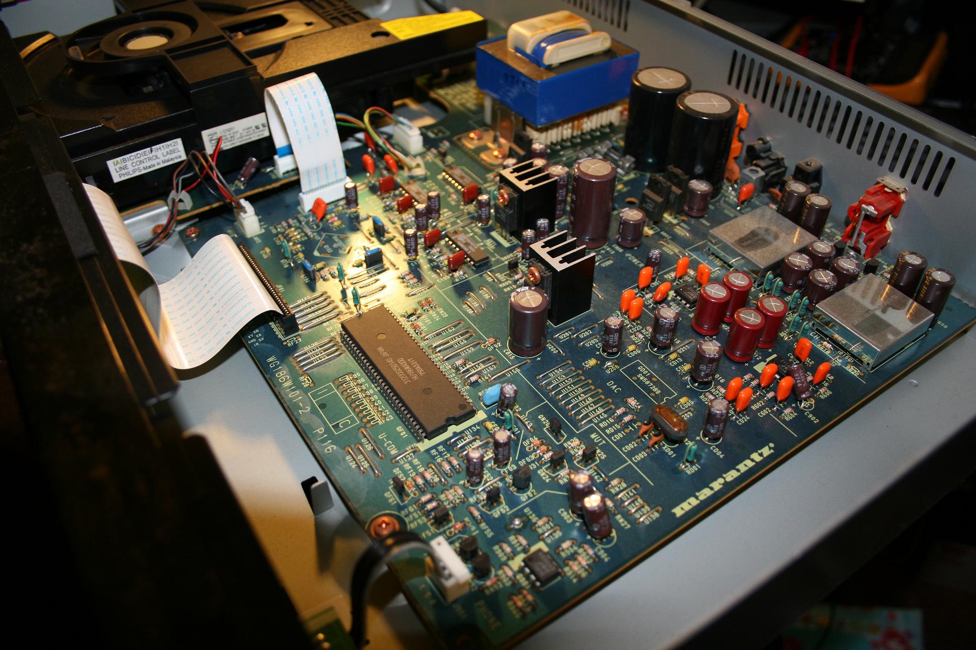

hi guys noob here. i have this cd player trying to upgrade but it already has super grade capacitors!! any cheap but effective mods any can recommend? cheers h
The best FREE mods are the removal of the muting transistors and the bypassing of the output caps. The rest is gonna cost you... 🙂
I wouldn't use OPA627 by the way, it's a single opamp and the ones in the player are dual, so you'll need four of these expensive beasts. Also, my personal opinion is that it sounds quite 'brown' (pun intended...) and muddy...
Good starting point for the opamps are OPA2134, AD826, AD8599, LM4562 (=LME49720), AD8620, LT1361. These are a few dual opamps that i've tried over the years and they sound a lot better compared to the original NJM2114. They are all drop-in replacements. Simply put two good IC sockets on the board (the ones with turned pin contacts, the others won't last very long) and start swapping!
But beware: some of these will reveal details that may not sound pleasant when the rest of your player is still unmodded. I would start with the OPA2134 if you want to avoid that, it sounds better than the 2114 but it is less revealing than the others.

Any suggestions for cheap output (dc blocking) caps (<$3)? I know none is better but I want them anyway. I've tried Panasonic PP 4.7uF 450V, which was great for low frequencies but terrible for treble, a 4.7uF Silmic II which was a bit harsh and 2x 4.7uF in series in opposite polarity to make a non-polar which seems best so far but dynamics could be better though.

I'm afraid there's no such thing as a cheap coupling cap that also sounds great...
In that price-range, you'll end up with entry-level metallized PP. A bit better when compared to an electrolytic, but most of them are not that great.
Check out Partconnexion, there's Axon, Solen PB and Clarity Cap PX that are not too expensive. Second in line are Mundorf EVO and Obbligato, but they are a bit more expensive.
May I ask why you want to keep them? If the DC offset at the output is low, you don't need them. Besides, most amplifiers have input caps.
The cheapest best-sounding output cap is a bare wire 🙂

I want to increase the Supplyvoltage of the Output Opamps. A few month back I allready replaced the 78/7912 Regs with some LM3x7. So my question can I just adjust/increase the voltage from 12 Volt to lets say 15 without increasing some Voltages elsewhere.
I allready did some investigations in the schematic...as far as I know it should be possible but im not sure if I miss something?

Hi Alex,
That wouldn't be a problem, as long as the electrolytics and opamps can handle the voltage.
Ray

One thing I was thinking of is the headphone circuit. This also runs on the same supply, and I don't know the max. voltage of the opamp in there. You may want to check it out if you haven't disabled the headphone circuit.
