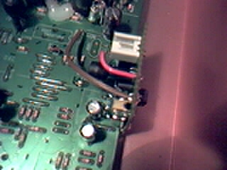

Andy,
I know there is al lot of discussion about regulators. Maybe i'll try a different setup in the future. But it is inconvinient to take the player apart and put it back together again all the time. Do that often enough and it will give problems.
I also got my hands on two TDA1541A's, i am going to try a non-oversampling DAC with these. See how it works out. Since i have an old philips player (CD650, with the service manual this time 🙂 , i can hook the DAC to the decoder without much problems. Easy then to get a first impression.
Anyway, here's the picture on the XO on the main PCB.
Guido
Guido

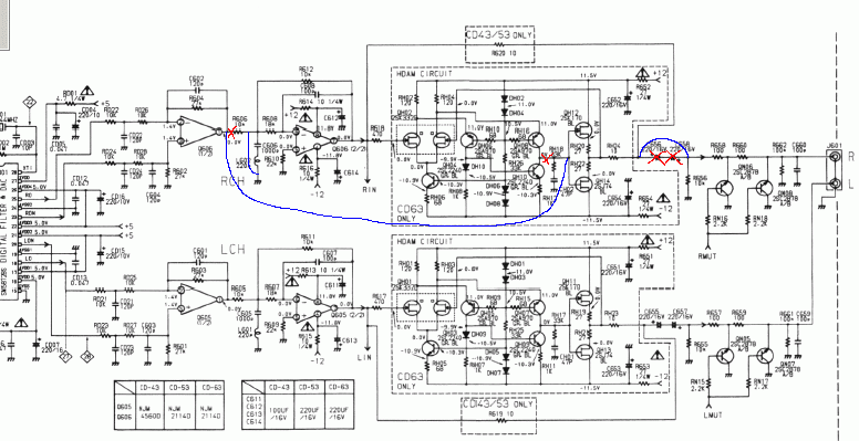

Joe, you are quite right. If I reread my posts with an eye of someone who hasn't spent countless hours inside this player it would be hard to keep up.... Well I at least try to make it better with the following...
First some links, likely you have already discovered them all
http://www.tnt-audio.com/clinica/cd67.html
http://www.tnt-audio.com/clinica/cd60pce.html
http://www.tnt-audio.com/clinica/cd63e.html
http://www.acoustica.org.uk/ -> clock hack
IMO the tweak steps that should be made and order I suggest is good would be following
1) eliminate the output electrolytic caps from analog output (C656, C658, C655, C657)
I have replaced them with wire jumpers. It would be wise to check the DC component at output connector with multimeter. In my experience it's never more than abou +/- 20mV, which is mostly of no concern. Only if you have a true direct coupled amp where there are no caps in signal line it might happen that the DC component will also be amplified and sent to speakers. I think there is no commercial amp built this way, but some DIY projects might be.
2) Change the opamps. National LM6172 seems to be the most popular candidate and is the one I'm using.
Here the most important is to make sure you will place the additional decoupling caps to the supplies of opamp as close to pins as possible. I have 0.1uF polyprop caps from pins 4 and 8 to ground. When choosing the caps go for the ones that have as small dimensions as possible and as short legs as possible. Also place a cap on top of the opamp between +/- pins (pins 4 and 8). The value of this cap is not critical. Here you should pick some sort of SMD cap with as big capacitance as possible. I used some that were soldered off of some scrapped Intel PC motherboards. It is (at least I think so) non polar cap and the DMM measured it 20uF !!! I don't know if its right but it fits well on top of SMD opamps (I didn't get DIP cases from RS for some reason, even though the part nr. was right). A good place to look for ideas about opamps and decoupling is audioasylum forum.
3)Modify the clock. Install a sepparate one or use the description on acoutica.org site. I did my clock mod very sililar to that independently and as it turns out the techical solutions were similar and also our findings about changes in sound...
4)Better decoupling to supply lines. Use your imagination here.... One warning though, I once decided to change almost all the el. caps in the player for better ones (Nichicon xx, I don't remember the series at the moment). So, I replaced them and to some places I just put bigger values than stock. Well as it turned out I managed to overtweak a bit and now it takes about 30 sec before the display lights up 🙂 I have studied it a bit, also with scope but can't fiqure out what causes the delay. Player starts normally and other than that there is no problem... so I have accepted it as just one more little thing that makes my player special.
I would suggest that it would be both wise and informative to make a few tweaks at the time. It is simpler to troubleshoot or reverse tweak and on the other hand it gives an idea of what kind of change any of these will make and do you like it or not.
It is also good if it would be possible to reverse any tweaks you'll do if needed. So when doing something try to think it over and if possible just cut the trace, leave one leg of a resistor open or wahtever...
Here is how I have my analog stage at the moment. Opamps are LM6172.
The blue lines are wire jumpers. The red crosses are places to cut a trace.....

That being said, it's time to start all over again.
Ahh, thanks guys - that's what I was hoping for. I think I have a much better idea of what to do, thanks to your posts!
A little story. I once had a Magnavox CD player that I pooged the heck out of. Bypassed every digital IC, replaced all the D/A filter caps with WIMA MKS, replaced the I/V and output op amps with an AD model, got rid of the MUTE transistors, got rid of the output coupling caps, ran a completely seperate, always energized power supply to the new output op-amps, bypassed them with WIMA MKPs, biased the op-amp outputs with a resistor to make them operate more class A, added a heat sink to the op-amp package and maybe some other a-specific stuff I dont recall...
I heard about the Marantz CD-63 and decided I wanted one. Did a side-by-side with the pooged phillips player and the Marantz at the dealer, using headphones. I could not hear any difference, so I passed on the Marantz.
A couple weeks later I bought the Marantz anyway, sold the Magnavox to a friend. GOSH I WISH I HAD THAT PARTICULAR UNIT BACK!

Matching R's after the DAC
Hello EC8010!
While you're at it with the CD63, match the 10k and 27k resistors on the +/- inputs of the first opamp. I managed to do it within 0,1% tolerance. If you take all out + the ones in the headphone amp, you'll probably find a match.
It made as big a difference as taking the output caps out.
Check URL=http://db.audioasylum.com/cgi/m.pl?forum=tweaks&n=18343&highlight=CD63+hdam&session=]Dave Stanten's mods[/URL] for closer instructions.
Guess the matching damps out a lot of the noice coming from the DAc together with the signal.
I haven't even matched the 27k 0,1%, but the difference is stunning!
Tom
P.S. Changed the valve sockets and one 0,1uF cap on my Quad II, but I doubt that was the problem if there ever was one...
Hello EC8010!
Tom
CD63 mods
Hello Zombie, thanks for the tips. I can order some 0.1% resistors and match them on a 4 1/2 digit DVM. However, it will be a while before I start playing with the CD players as I'm busy on another project at the moment.
If I were you, I would probably replace all three 100nF capacitors in the Quad II. A failure would just be too expensive. If you have access to a high-voltage insulation tester such as a Megger, you might like to test the old capacitors.
Putting a potentiometer in the place of the 27k to the ground you can obvioulsy trim the circuit...
Tom
Tom
Zombie said:Putting a potentiometer in the place of the 27k to the ground you can obviously trim the circuit...
It's a long while since I looked at D/A design, so I'm a bit rusty. Is the idea of the dual differential (or push-pull) DAC to reduce distortion as the MSB changes? Thus, one would need to monitor distortion at perhaps -60dBFS whilst adjusting the 27k. Is that what you had in mind?
Those unbiased electrolytic coupling capacitors are certainly coming out! And I'm not too happy about the muting transistors either. A relay would be nicer. And as for the (probably ceramic) filtering capacitors on the first and second op-amps...
