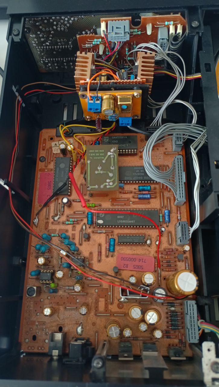

Hi, finally tried today on an old Philips CD373 that I have and although its early days, id say it did indeed sound better and more defined/spacious than simply using the coax output into my DAC
Once my clock arrives for the Marantz ill fit the clock then try this after a few listens.
Thanks for the help.

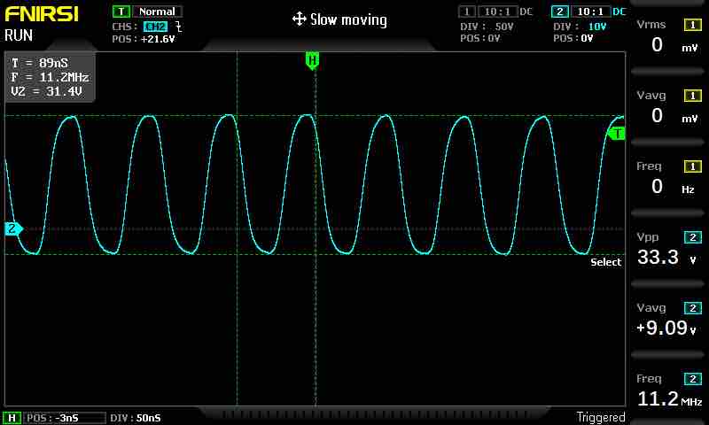

A little help please,
The clock I can only get it to work using a 9v battery?
When I connected to the 10v raw voltage supply of from a separate 7809 toc error occurs, but from a 9v battery it's fine.
Any ideas?
I've a feeling it's the 0v causing my lack of sleep.
Any ideas?
Long wires (can create high resistive signal path for HF so decoupling is key here) ? Is there a galvanic insulation between the power suppplies?
A voltage regulator is an oscillator too. Now you`ve got two powerful oscillators fighting each other. What a spectacle!
Found a nice new toroidal and made some pcb's with bridge rectifiers and 5v regulators for supply to dac, clock, saa7220 and 7210
Is it worth installing the toridial as its tight but possible or just stick with powering the regs from the current supply?
is it worth the effort for what will be gained if anything?
