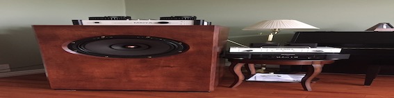

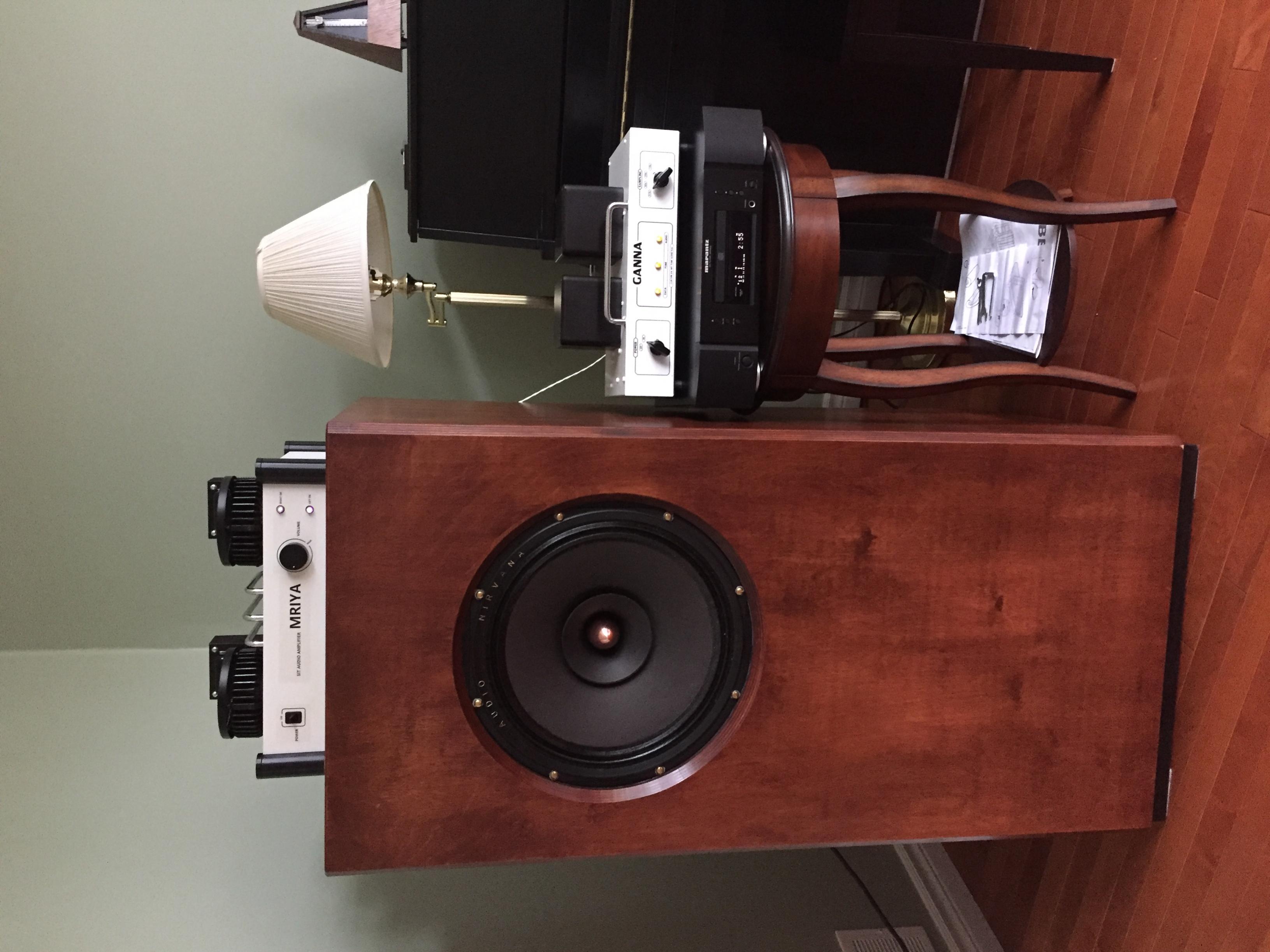

I heard the cd player today for the first time, through a couple of tube amps and a SIT amp into Alpair 10p Pencils. I heard it native and then just the digital out through a fancy multibit DAC. It was obvious that the external DAC was better sounding - clearer, especially in the treble. In fact it sounded really good with the external DAC. I can at least conclude that it’s a good cd player when used as a transport.
Had another listen today. This time on my Big'un speaker (Audio Nirvana Auper 15 Ferrite). I compared with the internal DAC and the external DAC (called Ganna in the photo). The difference was similar, the main change is in the treble. This time I felt the treble a little forward with the external DAC - the room is all hard surfaces. And I found it preferable to listen using the internal DAC even though clarity was very slightly less. I've developed a respect for this old Marantz player.
(apologies for the sideways photo - the forum software is rather dumb on this topic)
