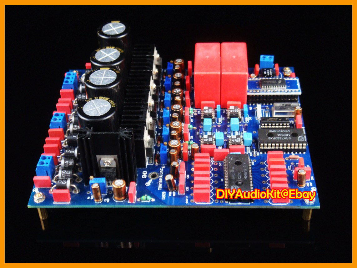

I think I already mentioned ' Vintage Audio Lab ' clocks on E Bay - remember ? The Red One ?
It'll do 11.289 - 5.6 and 2.8 simultaneously from a single 1PPM TCXO.
It cost me £25.00 + about 3 for post and was here in a week.
Even UV mentioned it to you as being OK.
You won't find better at that price. Nearest one that does something similar is going to cost you... A LOT..actually..£175😱
It's a very good one though and you might even be rich - in which case buy 2 !!
No...buy 3.... and send me one !!
1PPM 11.2896 MHz Low Jitter TCXO Crystal Clock for DAC - copy and paste this - I can't do the link thing for some reason.

I have that one on my watch list 🙂
I was thinking maybe I could get away cheaper and as good?? with a good PS and just a clock oscillator...just a thought.
But with that module I can get separate signals different Mhz to the different needs in the player, correct?
Why put it together myself if ready-made is better and cost-effective, never mind me over-reaching 🙄
No no - this IS the one you need.
You can send an 11.289 and 5.6 to the DAC chip and 11.289 to the 7210 and 7220 from this unit.
You even have the 2.8 you'll need later 😉
It has decent on board rectification and regulation too - simple 10VA 9v - 12v ac transformer and your off.
I've bought from VALAB before and they are a top ebay trader - buy with confidence .

As luck has it, I've got two 1x9Vac 10VA comming tomorrow or the day after 🙂
Will get that clock then, but I'll have to wait until the 21st or something due to banktransfer time to ebay(get paid the 19th). I never use creditcard there, I pay with paypal balance.
Will the 10VA single winding 9Vac trafo really be to small for 7220 PS?

Personally, I think it'll get hot !!
I've got 50 VA for this - it's too big yes.. but it is a really horrible chip and needs a heavyweight to make it work.
Eventually it becomes the best chip in your machine after the power supply and clock job.
Once you prevent it from distributing clock signals and get it off the main ps rails it's fantastic at what it does to bass resolution, sound stage and analogue liquidity.
Like a very high end record player is what I can compare it too - without the scratches !
NOS is NOT as good as this - and I've tried both - for me anyway.

So you think the 10VA trafo might overheat?
Info:
red leads: 230VAC / 50Hz input
blue leads: output
Specifications
voltage: 1 x 9V
current: 1 x 1200mA
rated power: 10.8VA
weight: 445g
dimensions:
height: 52mm
width: 60mm
depth: 45mm
If that's your spec then it looks OK - I hope it's fine when you load it

The kits are excellent value for money. It will cost 2x the price if you try to source the components yourself. I ran mine off 2 transformers both 2x15vac) giving me the 4 rails. The regs will run fine even with a large voltage drop for the 5v stuff.
Entry level kit
This one also looks interesting although the clock looks to be recovered from the SPDIF in this model. On the plus side the output stage is fully discrete!!
HiEND-TDA1541-DAC-CS8412-SAA7220-assembled-borad
I think there are a few threads on here about the 1st one. I think its refered to as the green dac?
Entry level kit
