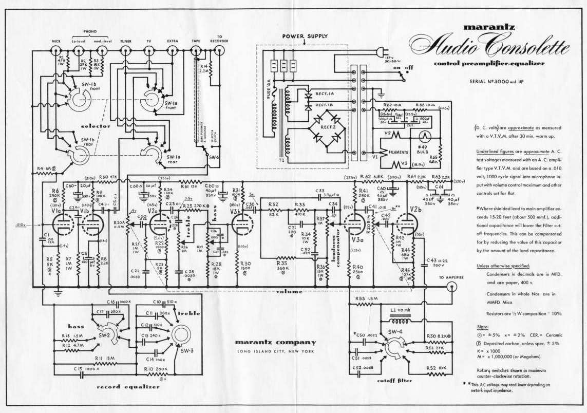

In my previous post I questioned why Marantz would have incorporated into the C7 what appears to be a much more complicated tone control arrangement compared to the Baxandall circuits but in looking over the schematic of the earlier Consolette Model 1 (see image), it seems they had used the Baxandall or something similar and scrapped it for the stepped RC arrangement a few years later in the C7.
I hadn't given the schematic a decent look over and I now see the lack of negative feedback.

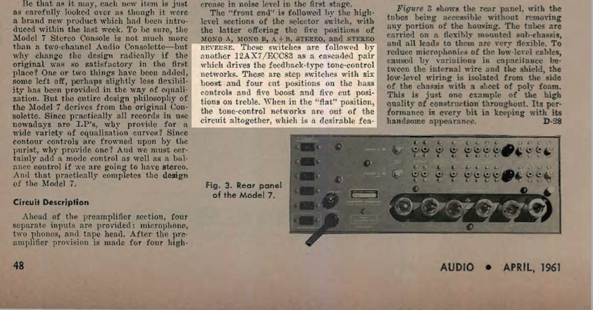

I found this review of the Marantz 7C in a 1961 Audio magazine clip which might be of interest regarding their mention of the tone controls boost and cut details.
