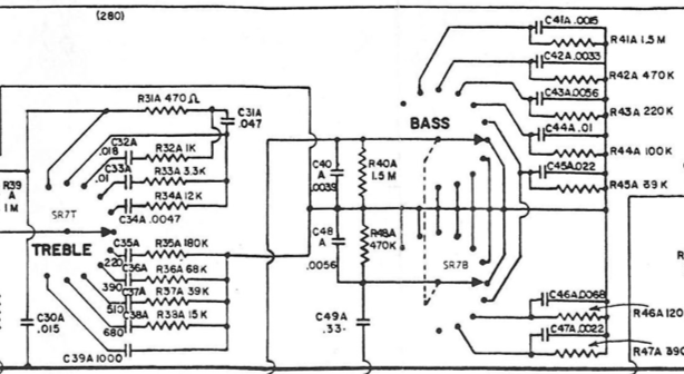

I want to duplicate the Marantz 7C tone stacks in my 7C replica build. I purchased what I thought would work for the bass tone rotary switch based on my interpretation of the schematic but in looking at photos of a disassembled 7C bass rotary switch and the level of complexity of the one Marantz used, I am wondering if what I want to use is capable.

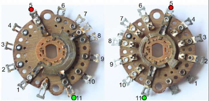

The Marantz switch is a dual deck 11 position with each deck having two poles. Each deck is dual sided with two different types of center conducting pad traces. The switch also has a termination disc further out from the two decks to attach the capacitors and resistors.
I purchased dual deck 11 position single pole switches and I can't see why it wouldn't work. I will be adding a terminal plate via long standoffs as Marantz used on their switches
Looking for someone to look at the attached schematic of the switch from the Marantz 7C schematic and photo of the switch I'm going to try and use and tell me if my simple 11 position dual deck rotary can perform the necessary switching?

I'm glad to hear others here also feel it should work.

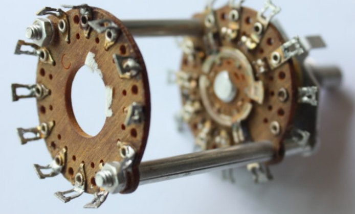

Thought I'd show a couple of photos showing the complexity of the C7 switch and then will ask an obvious question. What would have been their motivation behind using something that would have to be a custom engineered switch and that would cost them much more per switch compared to standard off the shelf offerings at the time? If a simple standard rotary design does the job, no company that I've ever heard of would add cost to a design unless it was required to perform the function or somehow saved labor $ somewhere else in an amount greater than the added expense.

Such switches were custom made for audio or other mfrs back then. Still are, since there are a vast number
of options, and no manufacturer or distributor would want to stock them all. The switches were made with
all standard parts coming right out of stock, just custom assembled to order, to make the configuration wanted.
That makes sense to me. Most likely was not much of an increase in cost but potentially allowed a big reduction in wiring and component connections which would equate to big savings in labor. I tried studying the circuit pathways that resulted using their switch versus the simple one I want to use and after getting cross eyed, I decided it would be too challenging. I'll wire it as I interpret the schematic and hopefully will end up with the same tone stack switching.
Only difference is the way all the RC connections are made to the preceding plate.
You'll have lots of wiring to do.
A soldered connection is better than the sliding switch contact anyway.
