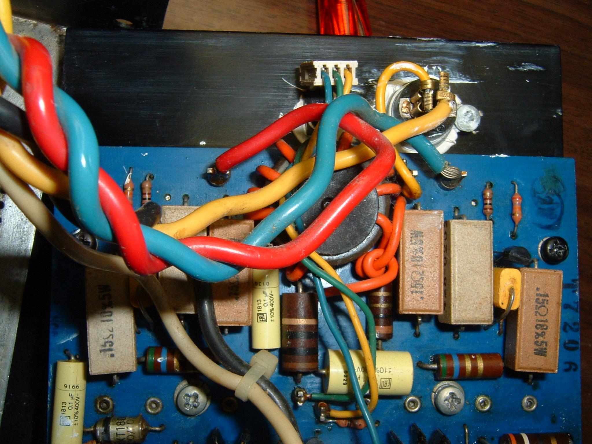

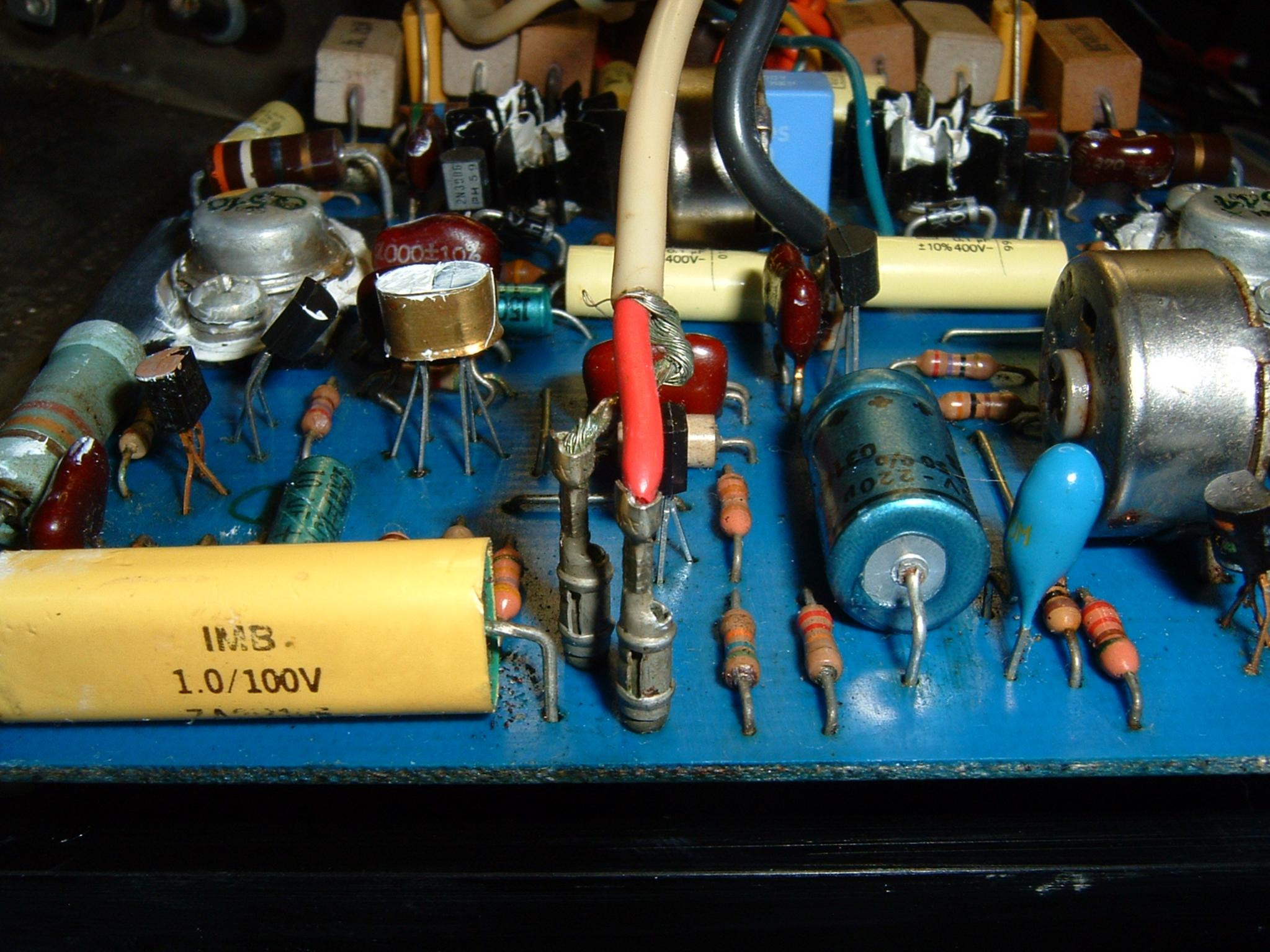

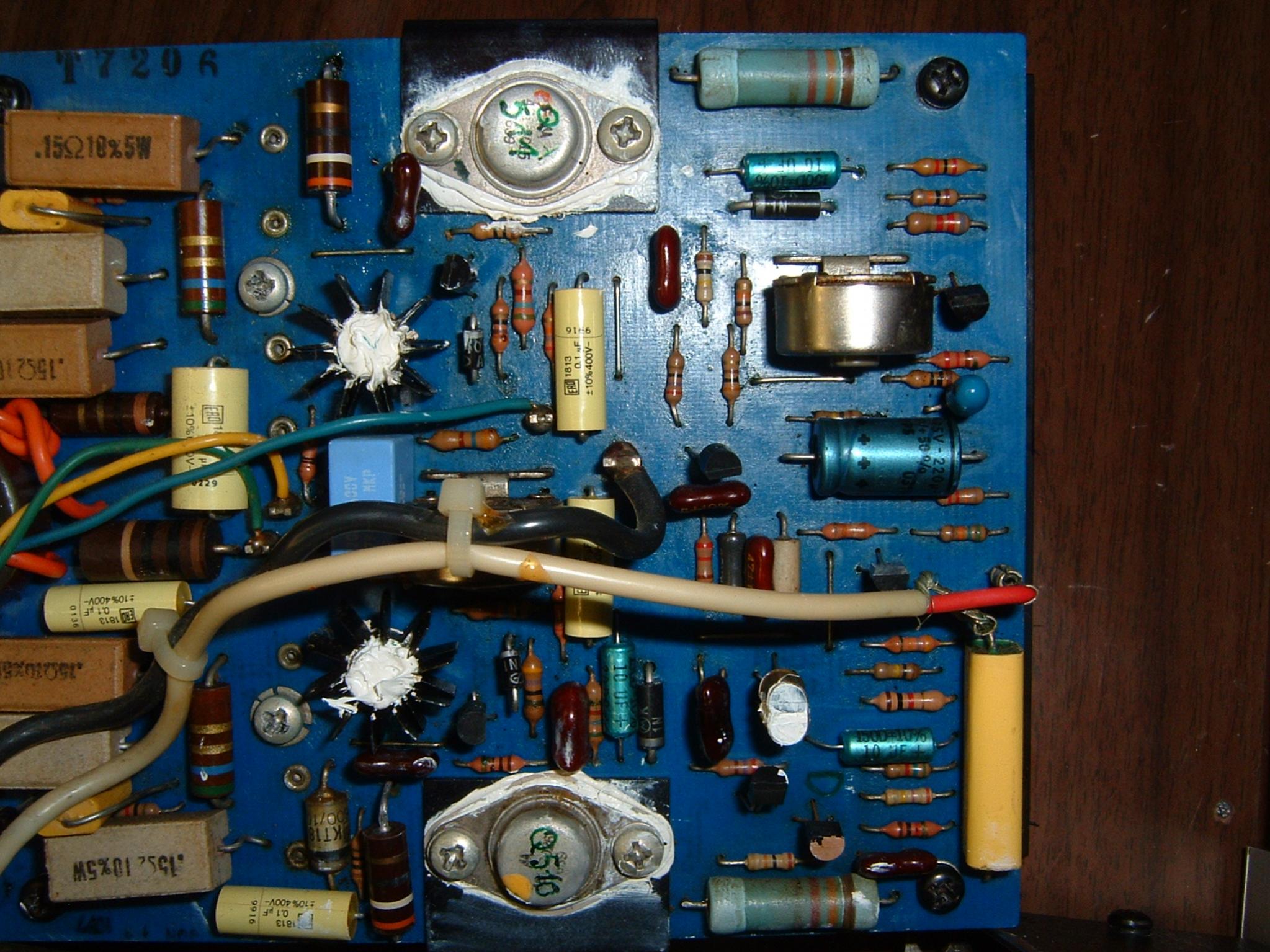

Hello there;
Here are some pic's to help you locate the 39 ohm resistors (upper-right and down-right thick resistors on the picture) and the bias-connector.I also noticed the 2 small transistors that are thermally connected on mine,the latter seems to be missing on yours=double check that.I do not own this amplifier anymore but still had some pics left.I think i still have 2 spare TO-66 driver transistors laying around somewhere.Hope this helps.
Have fun!
Grtngs;
Johan

Hello,
Small correction,those 39 ohm resistors are situated left to the driver transistors.That's in the middle of the picture,one at te top - the other at the bottom.

Jorre - take a look at my picture (post 40). I must have a significantly older model 250 than yours. My layout is completely different. I have no connectors and the connections to the driver transistors is crude point-to-point. I can clearly see the 39's on your arrangement. What S/N is that? This one is 1537.
