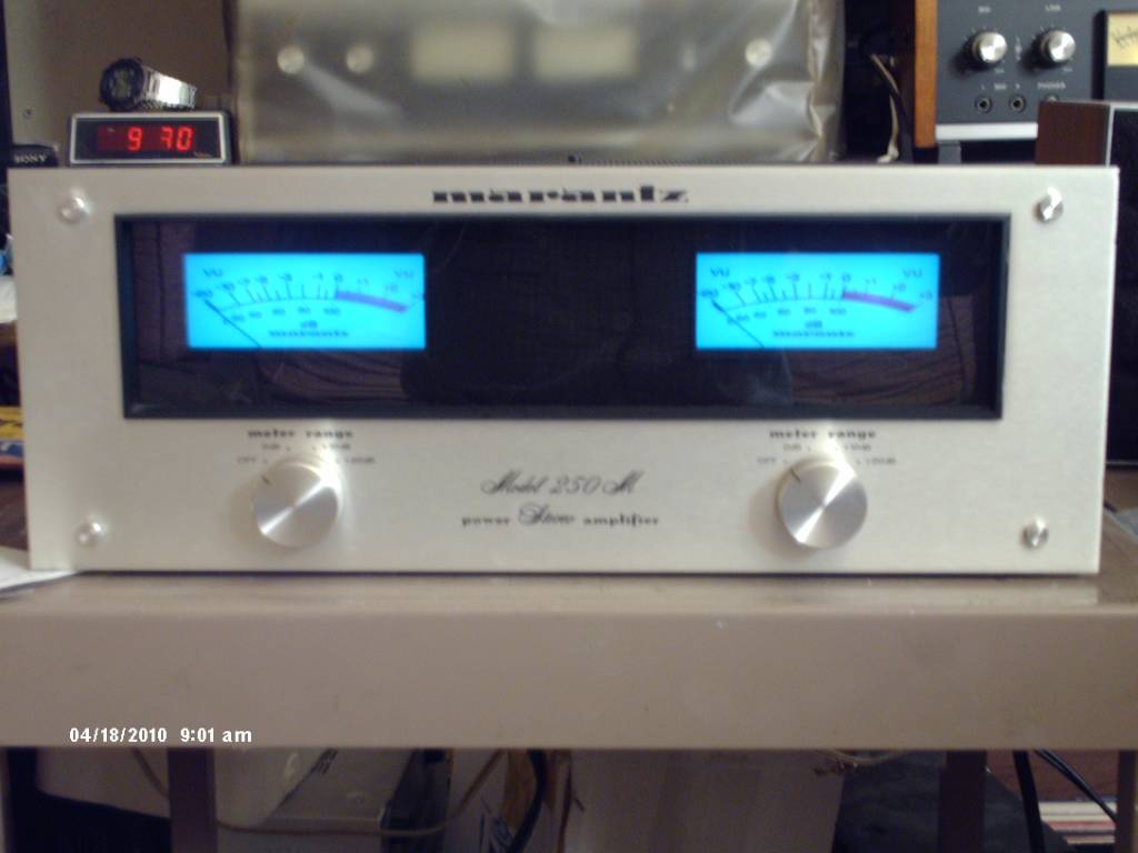

The 250M should arrive sometime this week.
I'll post as soon as it arrives.

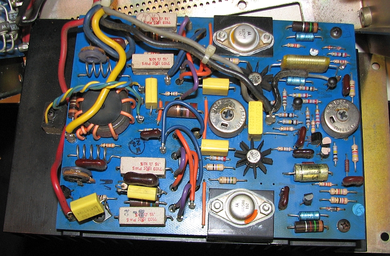

Did a visual on the right amp board. Marantz didn't mark componet reference numbers on the board. Big mistake.
I checked the resistance value of the burned resistor since one side was not burned. 39 ohms, 1 watt. Either R529 or R530. I'll check the polarity of Q510/11 to be certain.
Either way, it goes to Q510 or Q511, the NLA To-66. They measure Ok. That's good.
R529/30 then leads to the output transistors. All 4 are shorted.
BTW. The output transistors where replaced with the incorrect transistors. In addition, there was an over use of heatsink compond on Q510/11. Over applying the componud has the opposite effect. Instead of heat transfer it retains heat. Not good!
The output transistors had the opposite. Not enough HSC. They applied the compond to the outside of the mica insulator only, not to the surface of the transistor. Again, not good!

Not too much damage to the amp. The 39 ohm resistor (R529 or 530) and the output transistors on that channel.

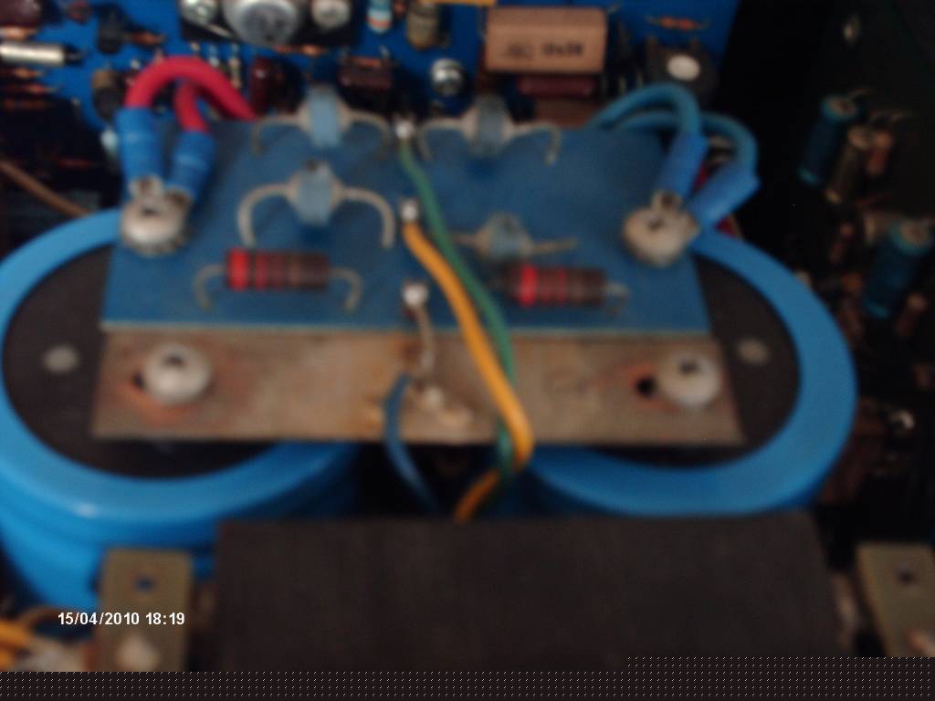

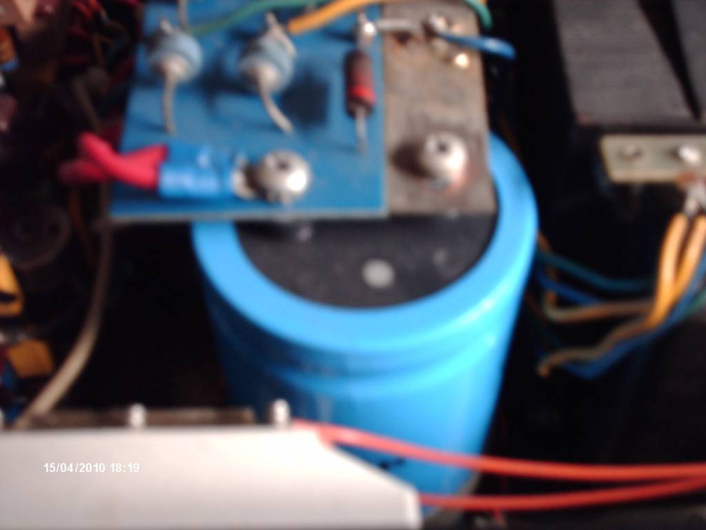

jblmar are you doing the power supply caps? Curious as to what you use that will be a good fit if so.
Pete,
The owner of the amp replaced them already. I'll check the make and ratings for you and PM the info to you as well as post here.

The 250M is repaired and back in operation.
The damage was limited to the 39 ohm resistor and output transistors on the right channel.
The left channel output transistors were replaced as well. Both sides using the MJ21193G & 94G.
The amp was 'worked on' by someone who slapped on whatever combination of output transistors on hand or what they felt was ok to use. They were very free with their use of heat sink compond. I got it all over myself and my cloths. Arron, I'll send you the cleaning bill.😀
Pete, the filter caps were replaced with 'TECH-CAp 20,000 uF 60V parts. A very nice fit!
