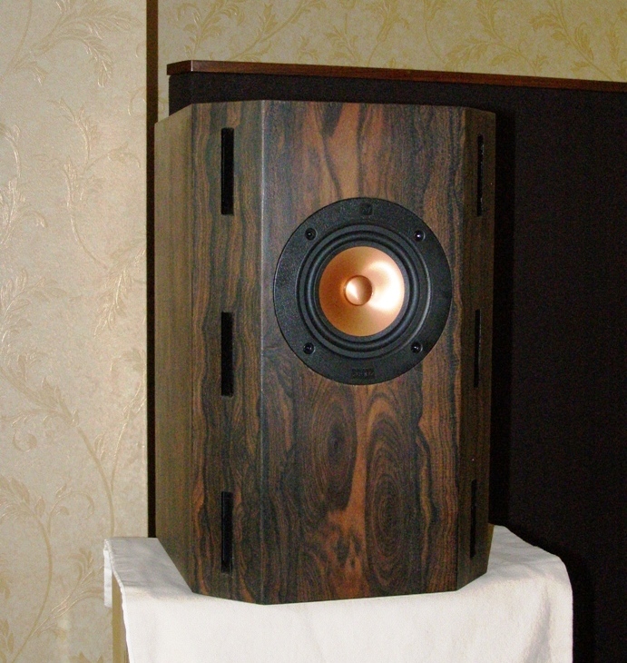

I have just finished a build of the dmar-Ken7.3 speakers for a guy who wanted a small pair of speakers to take with him on his travels so he can have something decent to listen to in his hotel room of nights.
Here's a couple of photos of them. They are finished in Ziricote veneer.
Interesting choice of finishing, I don't think I've seen this being done with the Mar-Ken's before.
How much do they weigh? You'd also need a flight case for that. I fly cattle class and usually get 20 KG. Thinking about the practicality of carrying them around. You'd also need wall support for decent SQ.

The choice of veneer was what the 'client wanted from the 20-odd samples of veneer I have available to me. Of all the finishes I tried Liberon Finishing Oil gave the most pleasing results.
Each speaker weighs just under 7kgs.
Yes some form of carry case is in the pipeline. Not sure yet what this will be. The main purpose of this is just to protect the speakers from damage during transit. If we can source some cheap(ish) aluminium flight cases suitably lined then fine. If not some bespoke thin ply cases with handles and suitable lining will be fabricated to size.
I don't think these are intended for International flight travel. Just travel, with overnight stays, in the UK. So they will be travelling in the boot of his car.

Colin - speaking from experience - if the owner is the only one handling them, then a light duty plywood box would be fine - if not, nothing short of a Pelican or similar case would suffice.
What Chris says. The design i've done is for simple handling. USPS exploded our build (someone in Ottawa will hopefully walk away with a 1st class, but slightly scared set of dMar-Ken7). We now have full on (home built) anvil cases with metal edge & corner reinforcement and 2x the latches.

A couple pelican cases, 1 for each would be very practical (and 1 for the iPod + amp)

As far as I know they will only be handled by Ali himself. So the sort of case you are describing seems to fit the bill.
I'll email you regards plans availability. Can't see any benefit in re-inventing the wheel if a suitable working and fit for purpose design exits.
I know what you mean about shipping containers. I now make up a wooden box for all my builds that are shipped by courier. And even then one courier managed to destroy one my wooden containers. I must admit though to only nailing on the sides (6mm MDF) to the 15mm MDF around frame on that one for a FH3 kit and now only ever make up a shipping crate that is screwed and glued together with all edges reinforced with gaffa tape.
