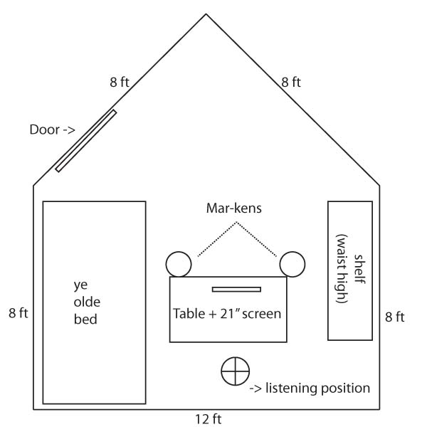

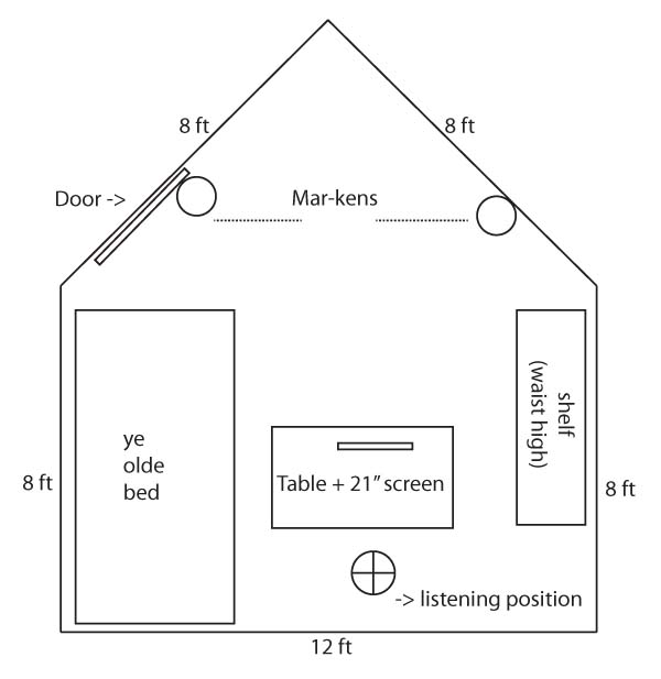

Mark,
First of all, thank you for building the wonderful piece of driver that is the Alpair 7.3. A lot has been said about its hi / mid performance. I believe that in a proper cabinet this driver has very good bass as well. I have auditioned several designs, and I'd say that the mOnken design by Dave sounds the best. The trick is to set them in the right kind of room and place them properly.
You are right, I do have a room with strange dimensions and acoustic properties. I wanted them in a nearfield monitor configuration and the verdict is that it doesn't work. Let me show you what I planned.
Yes, I do have a pentagon shaped room. This didn't work out at all. Perhaps this isn't the right unit for the job. More suited probably would be studio monitors like Focal CMS / Dynaudio which were designed for this specific purpose.
However, what worked superbly was this.
This placement gave me all the brilliant sonic performance it is known for. Bass is very good and a sub is not required at all. In a regular rectangular room, the ken's perform excellent when they are placed close to the walls, and the listener is sitting close to the opposite wall. I would say that my findings are similar to buzzforb.

I have found that when a conventional setup is not possible, a corner setup is a good alternative. Basically that's what you have -- a corner. One thing that happens with a 90* corner is that early reflections are almost completely eliminated with no wall treatments necessary. Excited room modes will be different, maybe good, maybe bad. Of course you can adjust the bass boost by how far the speakers are from the wall. All in all, a corner placement has its advantages.

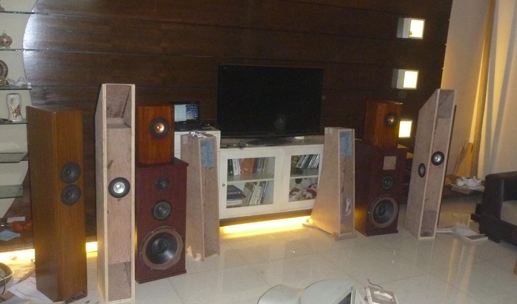

Our FAST session
We've been talking and thinking about FAST a lot recently... with amps and speakers lying around at my place and with a digital XO idea from Banglacx, we thought let's give it a try.
I had a pair of old 3 way speakers with 12 inch woofers lying around - retired since I had moved to Full-range. Well given that those boxes packed plenty of low end thump, we disconnected the other drivers and the crossovers and had the woofers directly hooked up to the terminals.
But how to do active XO? Banglacx came up with the idea to use ASIO4all and Foobar XO plug-in. This worked very well for our project.
We started off with some 100% FR listening for some time before switching to FAST. We auditioned all 3 speakers - the Wessex MLTL with EL-70, the Lotus^2 with CHR-70.2en, and the Mar-Ken with Alp 7.3. We used Banglacx's ICEPower amp for this. Made some mental notes of the sound and the differences among the 3 systems. Then came FAST experimentation...
We selected the ICEPower for the FR unit and a Dayton Tripath 50 wpc amp for the woofers. XO was set at 200 Hz and used the Lotus^2 to start off as FR unit. Once we got a hang of things, switched to the Mar-Ken 7.3 seen sitting on top of the woof boxes.
Integration with the Alp 7.3 was better. At 200 Hz XO the sound carried significantly more bass weight, and the Alp 7.3s performed freely. My woofers have a kind of PA driver feel to them - the bass is hard and deep. the music sounded very "live", with a wide and surprisingly tall profile, and very dynamic too. SPL was no problem. Both of us are more comfortable with moderate (<80 dB) listening, and we tested up to 90+ dB dynamic peaks with general levels around ~80 dB. It was apparent that louder would also be doable quite easily. Majority of our listening ended up around mid 70s SPL - but the system sounded BIG, we did not feel the urge or need to crank up higher. After 200 Hz we experimented with higher and lower XO levels. With higher (400 Hz) we felt that some of the magic of the Alp 7.3 was missing. When we dropped to 150 Hz, we both felt it gave us great results - it was like the Mar-Ken 7.3s maintained their characteristic sound and texture, but added some bass authority which sounded "just right". Integration was very good and the system sounded very musical. In the beginning of our testing session we were having to adjust the woofer volume levels a lot, towards the end we found a sweet spot and the system required little/no adjustment over different albums and genres.
I personally found the standalone Alp 7.3 sound in the Mar-Ken engaging yet relaxing; the FAST with my big woofers is more live and dynamic. Though FAST gives real full range (with test tunes 30 Hz was very audible), for me a balanced FR would work most of the times (70-75 dB) for most of my music; when mood and genre demand something more, then FAST. To enjoy the best of both worlds, my recipe would be having a competent FR speaker (like Mar-Ken or FH Mk3) and helper woofers (for FAST) with the freedom of using them when I want to.
Once I have the MA Woof #6 units in hand would like to give it a shot with the smaller woofers.
