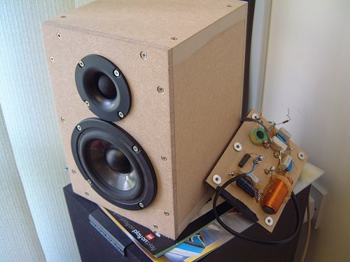

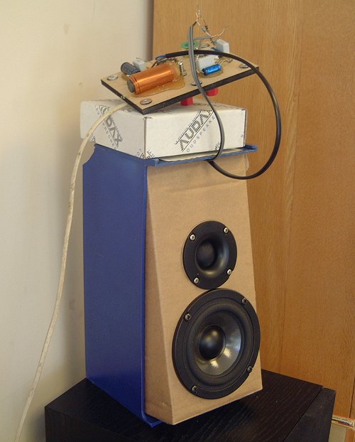

As this thread is active again, I hope it's ok to post this here…
Just recently, I rescued the crossovers from an old pair of Musical Fidelity Reference 2's - I remember these being quite good in their day. This lead me to think about testing my F1's that have been sat in my office drawer along with my AP100Z0's.
Using some storage cartons rescued from the skip, I made a quick mock-up (see the attachment). While these suffered from a few rattles, etc, they actually sounded very promising. I had to add a couple of resistors to bring down the level of the tweeters, but that's the only attempt so far to optimise the crossovers. The midrange and stereo imaging was particularly captivating...
This led me to thinking about proper enclosures. I downloaded WinISD, and started playing with enclosure design. I've only really done this by hand before, although I've played a bit with PerfBox (DOS), so it's nice to be able to experiment with ideas quickly…
But re-reading this thread, I found wildly varying TS parameters for the Z0. So I decided that I needed to make my own measurements (TNF). For the first time in about 6 months, I actually had some spare time at the weekend to devote to audio, so I made some measurements, and built a box suitable for measuring VAS…

Normally when I make anything from MDF, it's horrible. Not that this mattered for this application. But, the first box turned out so well that I just had to make another 😉 I spent a bit more time on the second, and it was even better. I bought a power-plane a few months ago to do some jobs on the house, and it works really well on MDF…
Onto the results: I only took 2 speakers home to measure, and they had not been used at all yet. But, despite no run-in time, the results aren't too bad:
#0 FS: 64.0 - VAS: 4.72 - Qms: 2.16 - Qes: 0.63 - Qts: 0.49
#1 FS: 66.9 - VAS: 3.46 - Qms: 1.65 - Qes: 0.67 - Qts: 0.47
#2 FS: 65.6 - VAS: 3.56 - Qms: 1.78 - Qes: 0.74 - Qts: 0.52
(#0 is Audax's spec's)
I suspect that VAS is a bit out because I didn't include the volume of air taken by the cone. The individual Q values vary a bit, but the total Qts isn't bad. These results were made using good "old fashioned" manual measurements, and I used the spreadsheet you can download from here http://www.diysubwoofers.org/measure.htm to make things a little easier. So how are you all measuring them? I've seen FS results as high as 90Hz, which is worrying!
Anyway, here's a picture of one of the prototypes, made from scraps of 6 and 18mm MDF - box volume is 3.3 litres, and the walls have been lined with some of the foam from the old Ref 2's. The finished versions will use birch ply if my crazy plan turns out to be practical, and should be slightly smaller… I've been listening to these in the office all week, and they're rather nice. The bass response is very clean, and quite well extended for their size (F3 is around 95Hz) 😉
