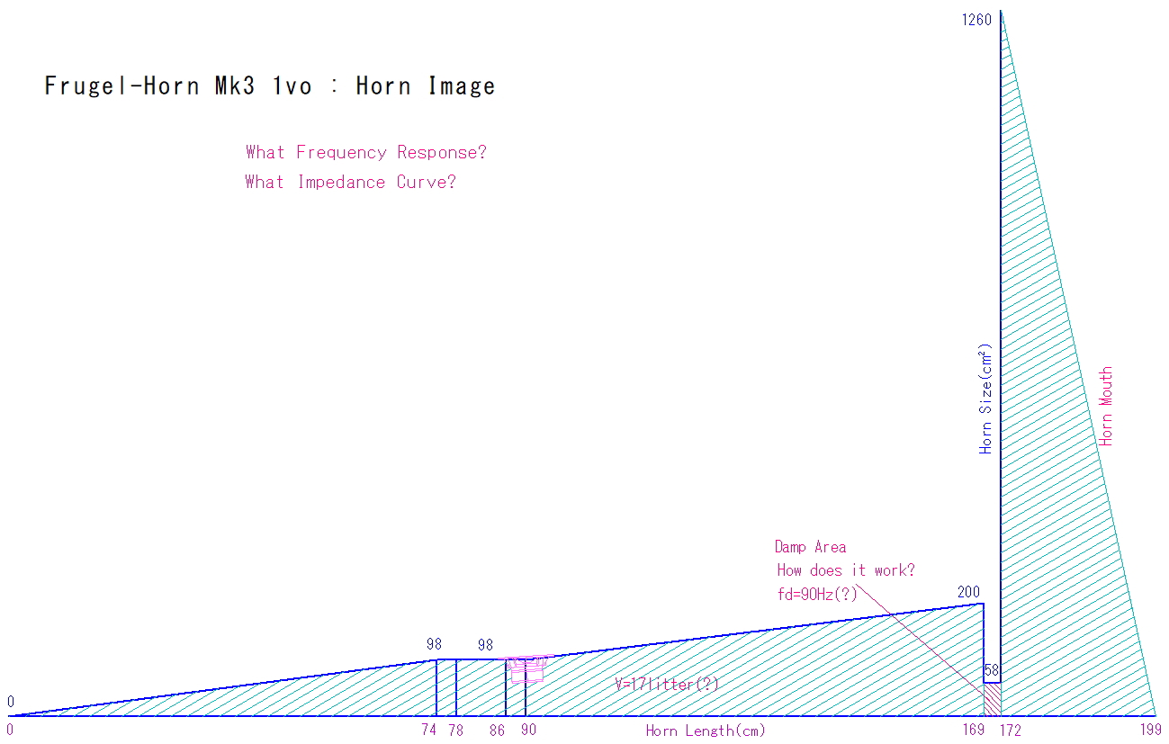

Cabinet for MAOP10 - Stagger Damp-Duct Back-loaded Horn Enclosure
FH are tapped BLH horns. The choke point is a trick from Paul Klipsch.
Not sure what you ar etrying to do by removing the horn mouth. Someone tired to commercialize a version simialr to what you did at the top. The horn mouth is important. The one at the bottom would just screw things up.
dave
