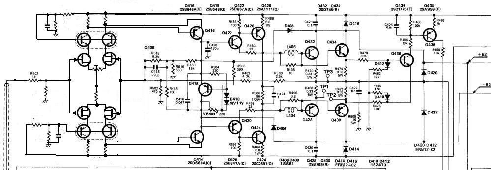

what's needed ........ except changing resistors , and decreasing overall gain ...... is something like this ( just rough sketch ) :

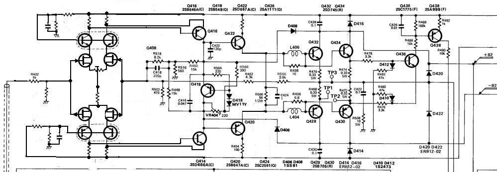

ZM, I would try to (referring to sch. from post #48 of this thread) remove CFP pairs (Q422/Q426 and Q420/Q424) and put nice simple emitter followers to drive the output BJTs.
I never liked the sonics of CFP, it always sounds limited, tightened, lifeless, EF is a better choice to me...
Also, I would take out output BJTs and use IRFP240/9140 (in EF topology) which could be driven directly from Q414/Q416 (with, let's say, 10 mA running through them). That way you don't need pre-drivers at all (gain from cascoded JC-2 is more than enough)....
juma said:ZM, I would try to (referring to sch. from post #48 of this thread) remove CFP pairs (Q422/Q426 and Q420/Q424) and put nice simple emitter followers to drive the output BJTs.

Yeah, you are right - too much work, it will be OK with BJTs, it's just that I have a full beg of IRFPs and crazy notion to minimize component count.... 😕

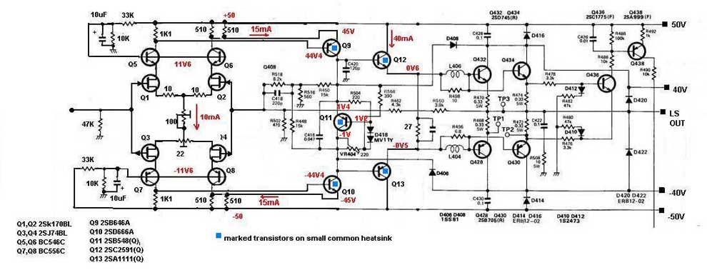

Zen Mod said:good enough ?
Collector resistors on drivers (Q420/Q422) are not needed any more and R506 might need a bit of experimenting, but you know that already
Don't forget to report back on results 😉
