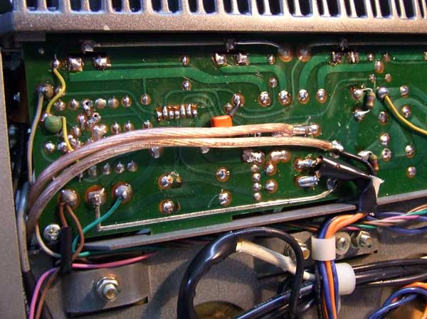

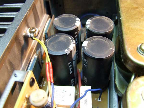

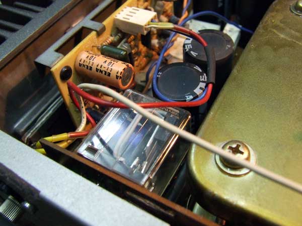

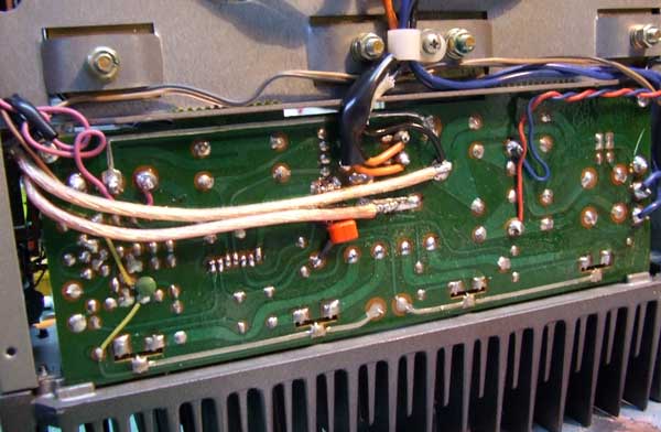

here it is - beauty top other ch (which is right , which is left 😀 )
same - other channel - origigi Silver pcb

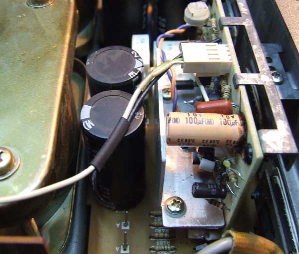

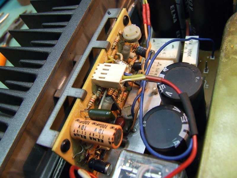

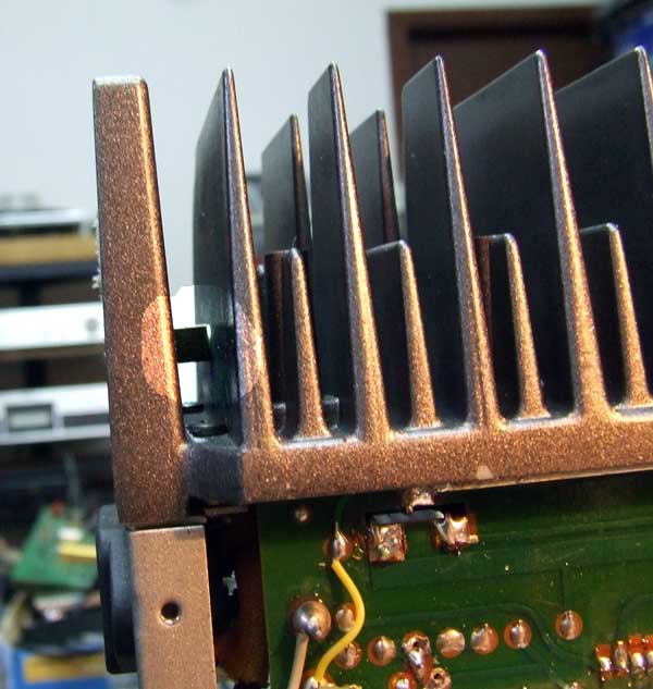

lookie - predriver/driver htsnk isn't L shaped - it's smaller
they're (both) scorching hot , even on bias set by SM;
I need to make biggest I can squeeze in , to be able to up bias ........ plan is 40W on heatsinks .... ~ 500mA Iq , or just 10W per output xistor

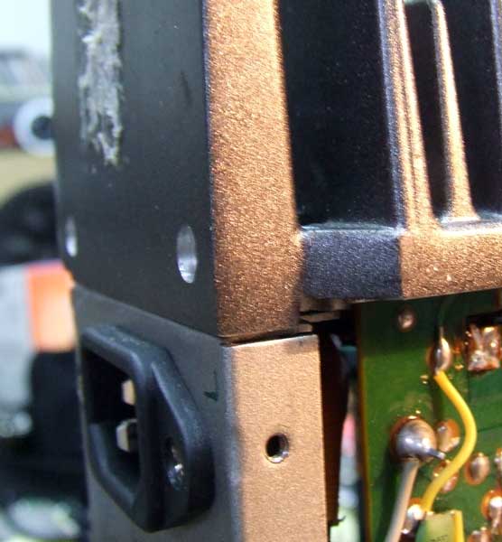

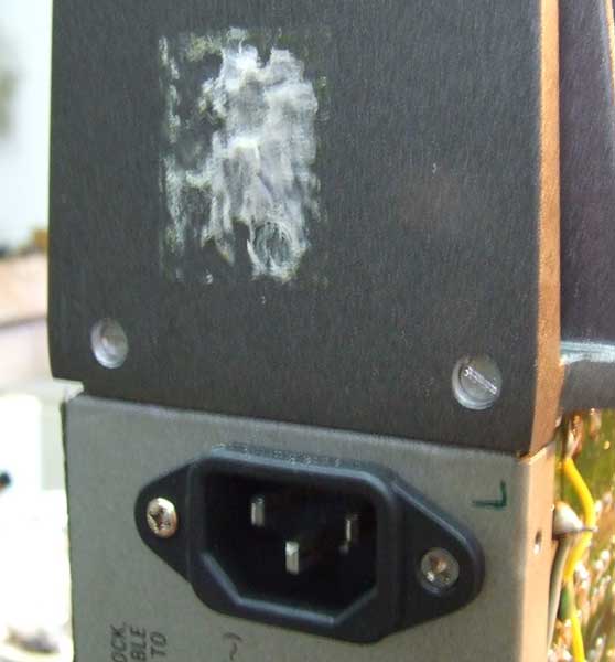

I want it ...
BTW nice glue repair ...
... good job ... perfect in fact..
Manu
I want it ...
Manu
Manu said:Naaaahhh. no uuups
I want it ...
BTW nice glue repair ...... good job ... perfect in fact..
Manu
for your eyes only - glue was just a filler , in fact

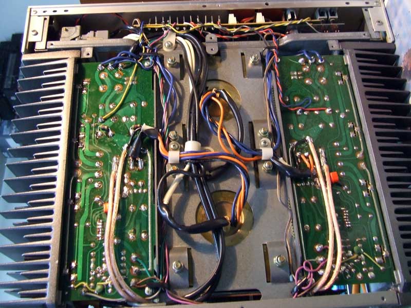

anyway - I tested ( repaired ) one combo few years ago - that's why I had idea to pursuing them
for testing purposes , I tried it in clipping too ;
you can imaging how heavy clip is - 80Vpp , with enough sine input (at 440Hz) that looks almost as perfect square
OK - I cheated - without load on output
edit :
plan is - to exchange all resistors to MF , tweak input resistance , check dissipation of predrivers , change input cap , decrease Iq ( to burning hand point ~ 40-50W/channel) tweak value of 1uF cap across Vbe multiplier ( bias xistor) ;
after that - preamp - HK725 ; it's in fact very nice discrete OP with Jfet input ;
