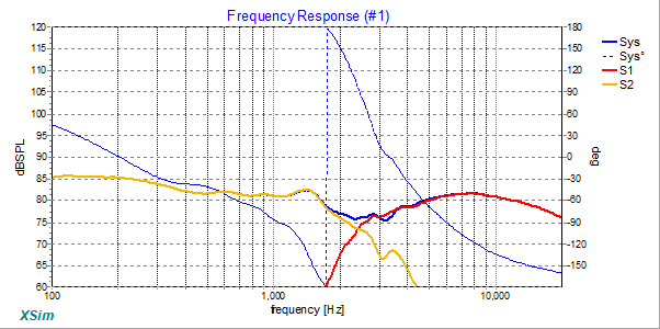

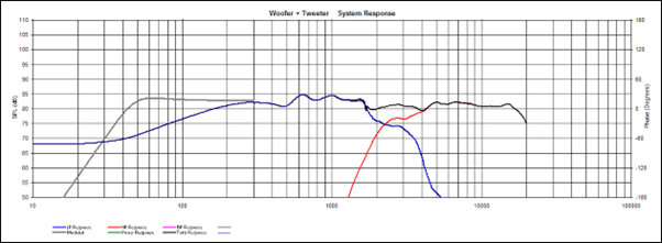

Here's an example of what I'm talking about: Paul Carmody's "Classix II" speakers:
The top one is the Xsim model, using the same crossover parts but with data obtained using the makers' graphs and fptrace. The second is how it measures in real life, from Mr Carmody's website (thank you Paul, I love those speakers!)

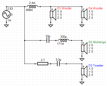

Hello. Can someone help me with making crossover? First of all I understand some basic things how it works but for most part I'm noob. I have speakers US Blaster 4011 in custom box without their original crossover and I would like to make crossover for them. There is 2 woofers 1 midrange and 1 tweeter. Each woofer is 16ohm and mid and tweet are each 8ohm. So I would like of it's possible to make decent crossover for them but also I would like if it possible for them to stay in 8ohm range for amp. I guess if I connect them all parallel that would be easiest for crossover making but impedance won't me near 8ohm and I want to be 8ohm or at least 6ohm lowest. Any advice appreciated.
I guess if I connect them all parallel that would be easiest for crossover making but impedance won't me near 8ohm...
Just to reassure you that, if connected as shown in the above schematic, the amplifier will see a load of 8 ohm at all frequencies - bass, mid and treble.
That is, the crossover components will ensure that the impedance of the speaker system as a whole will be 8 ohm.
Thank you for that information. One of the most confusing things in crossovers design for me was exactly that and will speaker be connected parallel and be seen by amp as parallel unit or it will be for amp like separate and each of them for certain frequency would be good for amp required impedance. Thanks a lot.
Reactions: 1 user
Would it be safe if I use for tweeter filter resistor ceramic one 1.5ohm 5w or to put 2 of those in series according to schematic from post #11 , and also for woofer filter is it okay to use 2 smaller inductors in series, would they work like 1 bigger inductor ? Example 2x0.5mH in series would that be like 1mH inductor?
