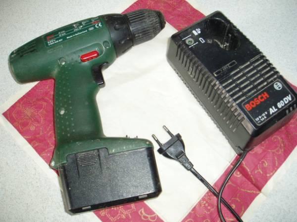

I found a used Bosch 9.6V (green series) with a fast charger for ~26$ with shipping.
I have one just like it (blue "pro" series) and it works very well. It has ~10 torque settings, two gears and is nicely balanced. The battery is refurbished with 3aH cells.
Somewhere in the stash I have a complete motor-gear-assembly from a similar Bosch, so all-in-all I should be set up for years of speaker-building 🙂, even if one of my Bosch´ fail.
Regards TroelsM
