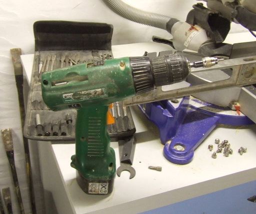

I bought a whole drill for $20 at the supermarket because it was 12 volts (for car battery lead afterward) and I only needed to drill 2 holes. Make sure whatever you buy is faster than 450 RPM. 1800 to 2000 RPM is good.

Hi all.
Thanks for the valuable feedback.
I found a used Bosch 9.6V (green series) with a fast charger for ~26$ with shipping.
I have one just like it (blue "pro" series) and it works very well. It has ~10 torque settings, two gears and is nicely balanced. The battery is refurbished with 3aH cells.
Somewhere in the stash I have a complete motor-gear-assembly from a similar Bosch, so all-in-all I should be set up for years of speaker-building 🙂, even if one of my Bosch´ fail.
Regards TroelsM
