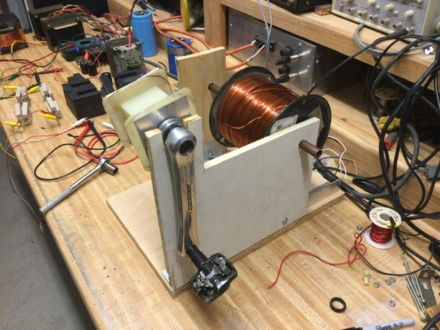

It’s fairly easy to put together a hand crank to make transformers and speaker inductors. Saves a lot of wear and tear on your fingers. You can make your own bobbins out of a piece of PVC pipe and a couple pieces of 1/8” wood/fiberboard if you don’t need to fit transformer laminations in them. While getting relatively orderly rows of turns isn’t critical, it helps get the most turns with the minimum length wire.

That is a great idea. Click your foot on and you have two free hands for guiding the wire.

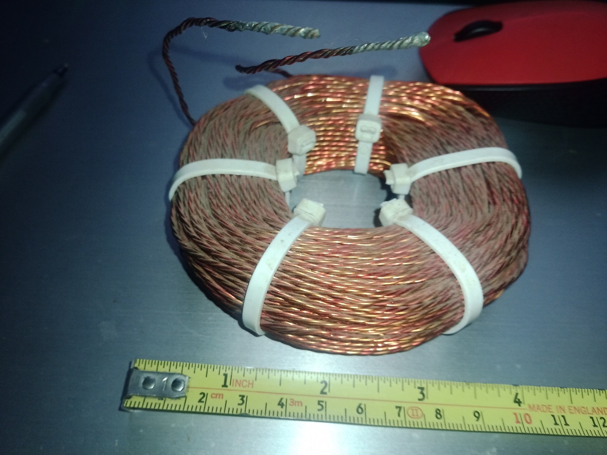

When I made mine, I wound them on a lathe using a wooden former and side cheeks. Take it carefully and don't get caught in the wire. (unlike my hair when I was twisting the strands together initially!). This one is 2.2mh, I made 4.
Though if doing a few, the cheap winders might be a better idea.
