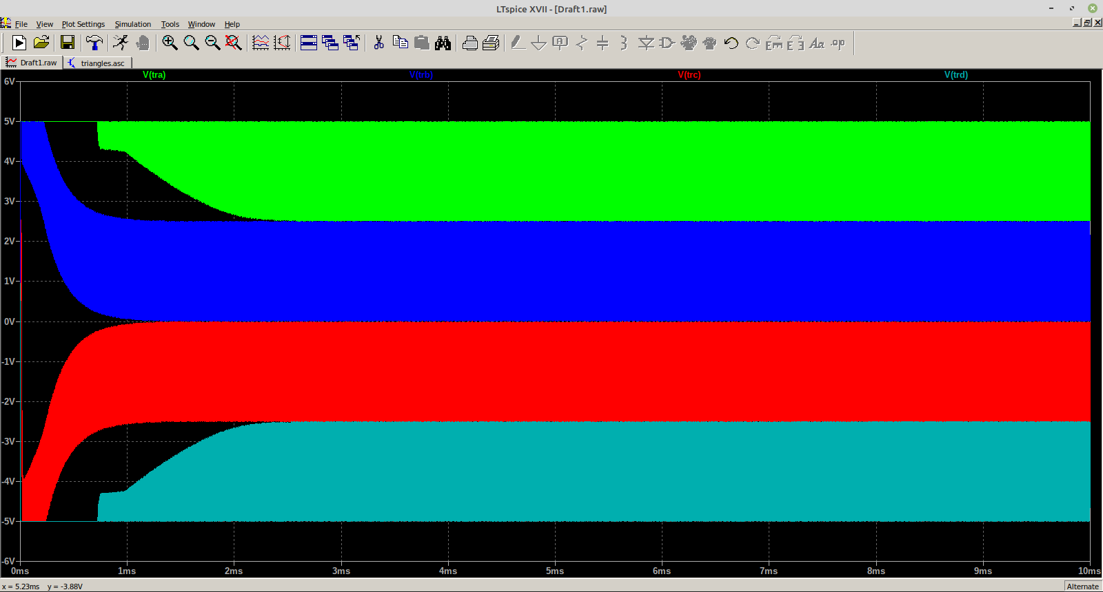

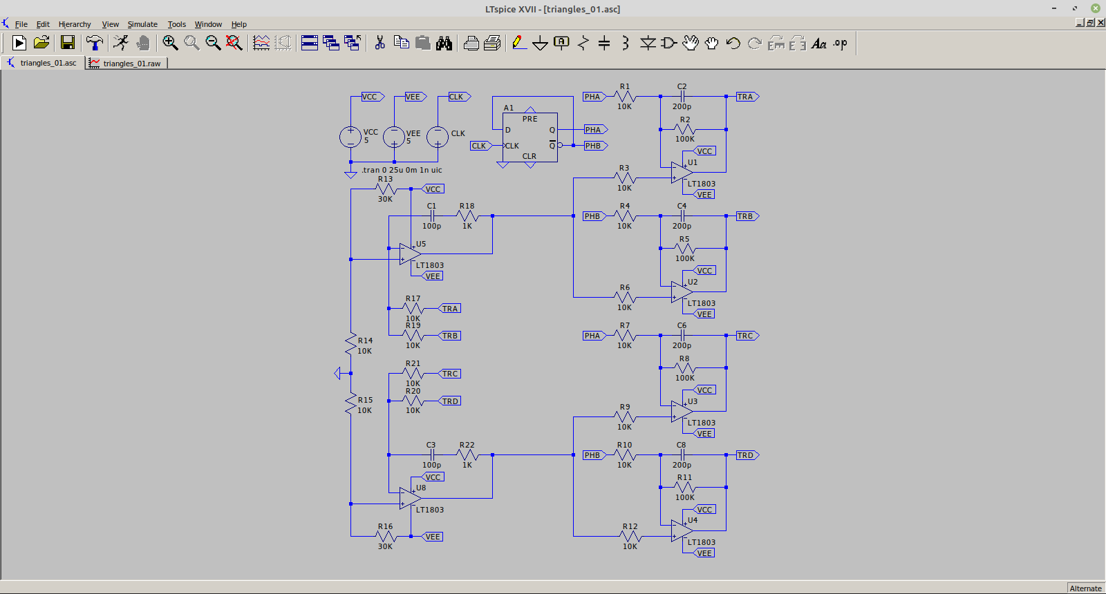

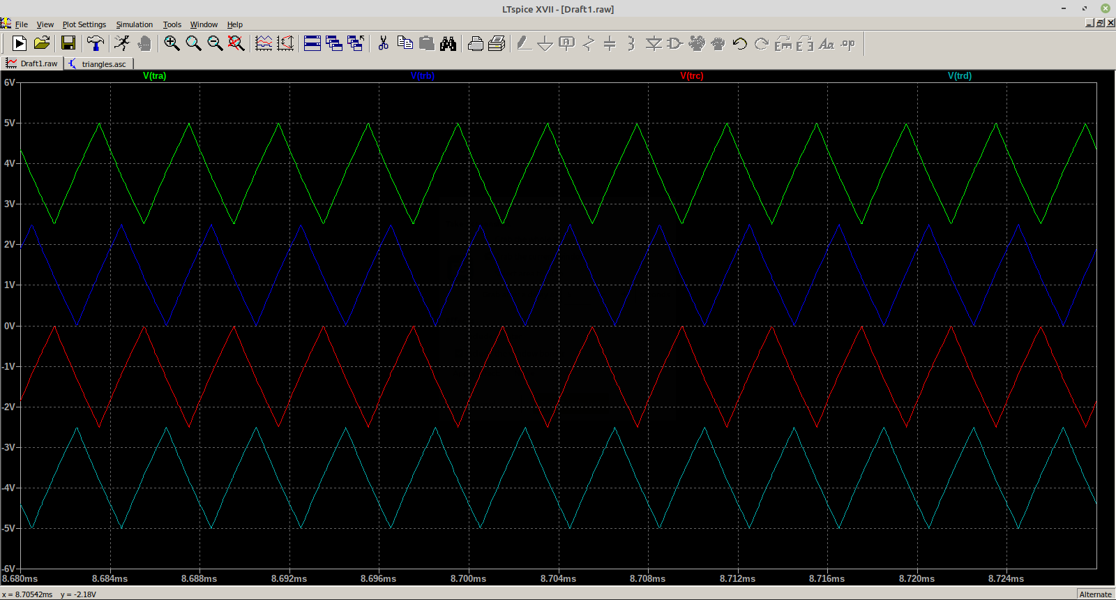

Not exactly what you want but

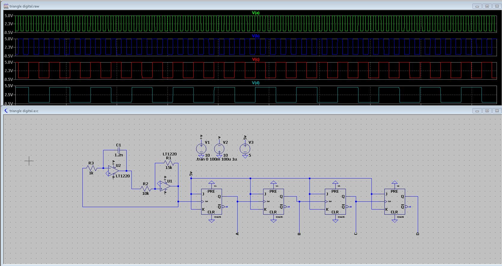

Here is what I think she mean, this is the master osc and the ripple counter, then we need a encoder, But what kind? then a 4 bit integrator masking the four signals fase shifted 180 degree. Did search on googe for 4 bit integrator, but none, do I need then a dac or such, mine digital knowledge is not that high.

You guys do realise you just did the OP's homework for him ... right?
Not quite, because I have done the version with 4 opamps in past already, but need a very stable offsets to prevent overlapping the triangles and afcourse the double sampling. The opamps has caps on input, digital is much more stable and precise I think, that is why these paper did mention that.
I had seen a pic also on internet of a digital triangle setup.

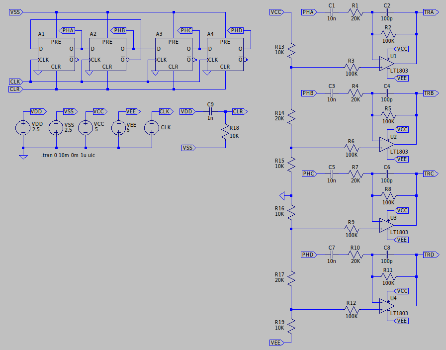

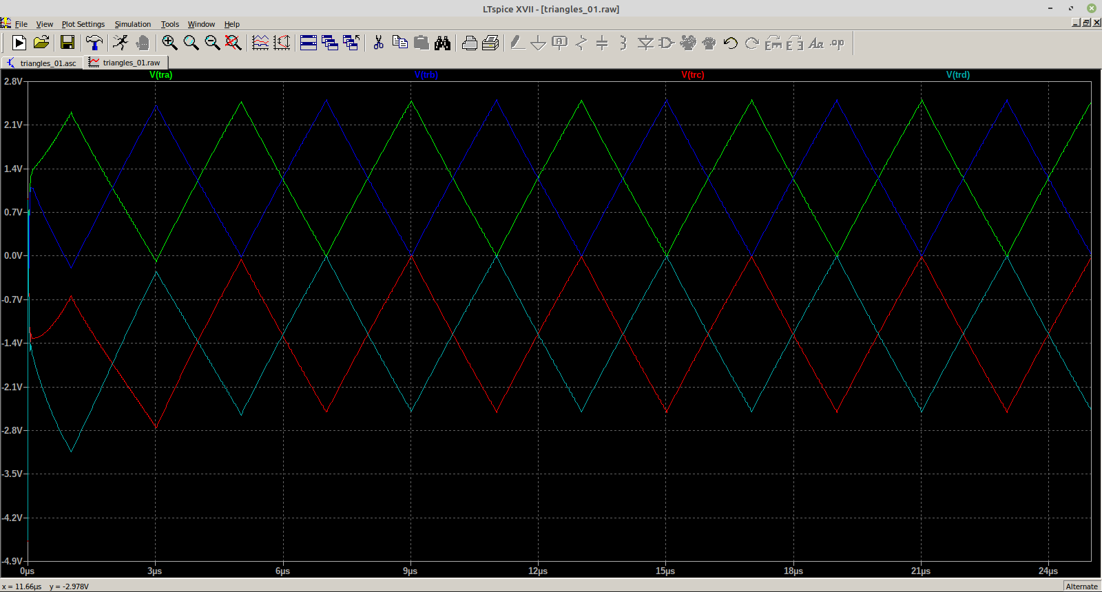

OK... I get the desire to avoid overlap at zero crossing with the possible cross conduction. You mention you have done this in a similar way with op-amps before but it suffers from settling or set up time. That is always going to be the case even if you implement a digital solution. You just have to hold off on power switching until your digital or analogue circuit has settled. You can remove the input capacitors to the integrators if you buffer the offsets and then you can go one stage further and and servo the offsets. I have not looked closely at stability in the servo loops but perhaps one cute thing is that ripple gets cancelled.

I had done this before and the question is not of the overlap can be prevented or not, it has to be prevented, but also the crossover and double sampling is a problem and distortion what happens, I had done a 8 level class d has in sim -100 dB beauty is, yes it is complicated, but I can use a very low switching frequency and can even with open loop get low distortion, but crossover or not depends of these overlaps, these need precise, even with 1 % resistors and a very stable supply, that is what I did read is that make it digitally, however the paper is not complete to see how it be done.

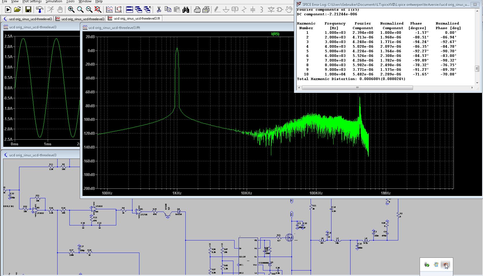

On pic is what I did a time ago, also with opamps following it, using dflops who have symetrical output voltages help get rid of capacitors and have a more steady offset.

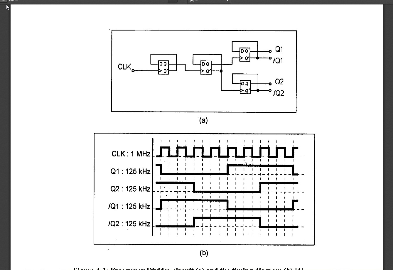

I've done similar myself given the logic is generally presented as being a simple means of producing quadrature, 90 degree, outputs. Unfortunately as you move to a higher number of phases, >4, the operation as what is effectively a ripple counter introduces timing delays. The ring counter method is synchronous so all edges change on the clock. It is also simply implemented using 74HC175 quad D type flip flops.
Looking at the paper,
http://oaji.net/articles/2017/1992-1525435871.pdf
The fact that the authors present a wordy description with no supporting diagram or circuit suggests that it might be more of a wish list than something that could be reliably implemented. Whilst they have the advantage of integration they still have to implement 5 capacitors, big on silicon and not necessarily such tight tolerance, so the result will probably suffer.
In amplitude terms you will always suffer from component tolerances but you also have to factor in timing delays. Rather than deal with them directly in as much as you can apply the servo method to the offset you could also adapt it to precisely adjust out cross conduction. Set up the servos to always drift into a result where cross-conduction is present and use a detection of that cross-conduction to continuously back them off.
With a bit of head scratching it should be possible in this case to generate all four triangles by using a single integrator and then just invert and level shift for the other outputs using basic amplifiers then servo them to the right place in terms of being on the limit of cross-conduction. That may/will be still limited by component tolerances and other contributors such as input voltage and bias offsets.

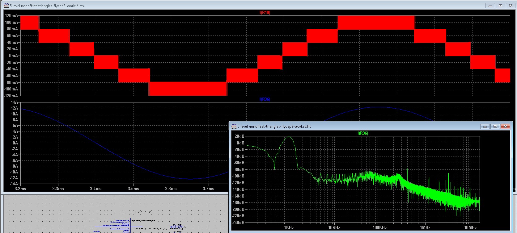

here the 8 level tryout, with postfilter feedback, the feedback network is recalculated from a paper, and with that author I had mail exchange about it in multilevel amps, seen the faseshift in such network can ruin the multiplication factor and lose the supression of the lower switching frequency,s.
Schematic is a cascaded output, needs multy supply,s for a single one we need capacitor version.
