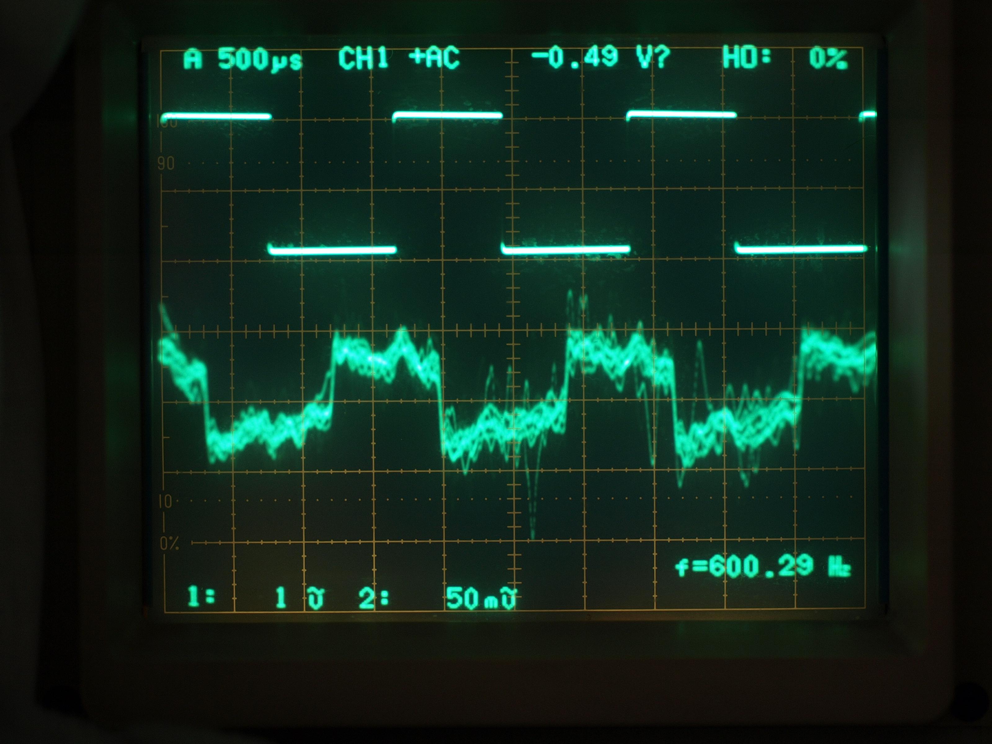

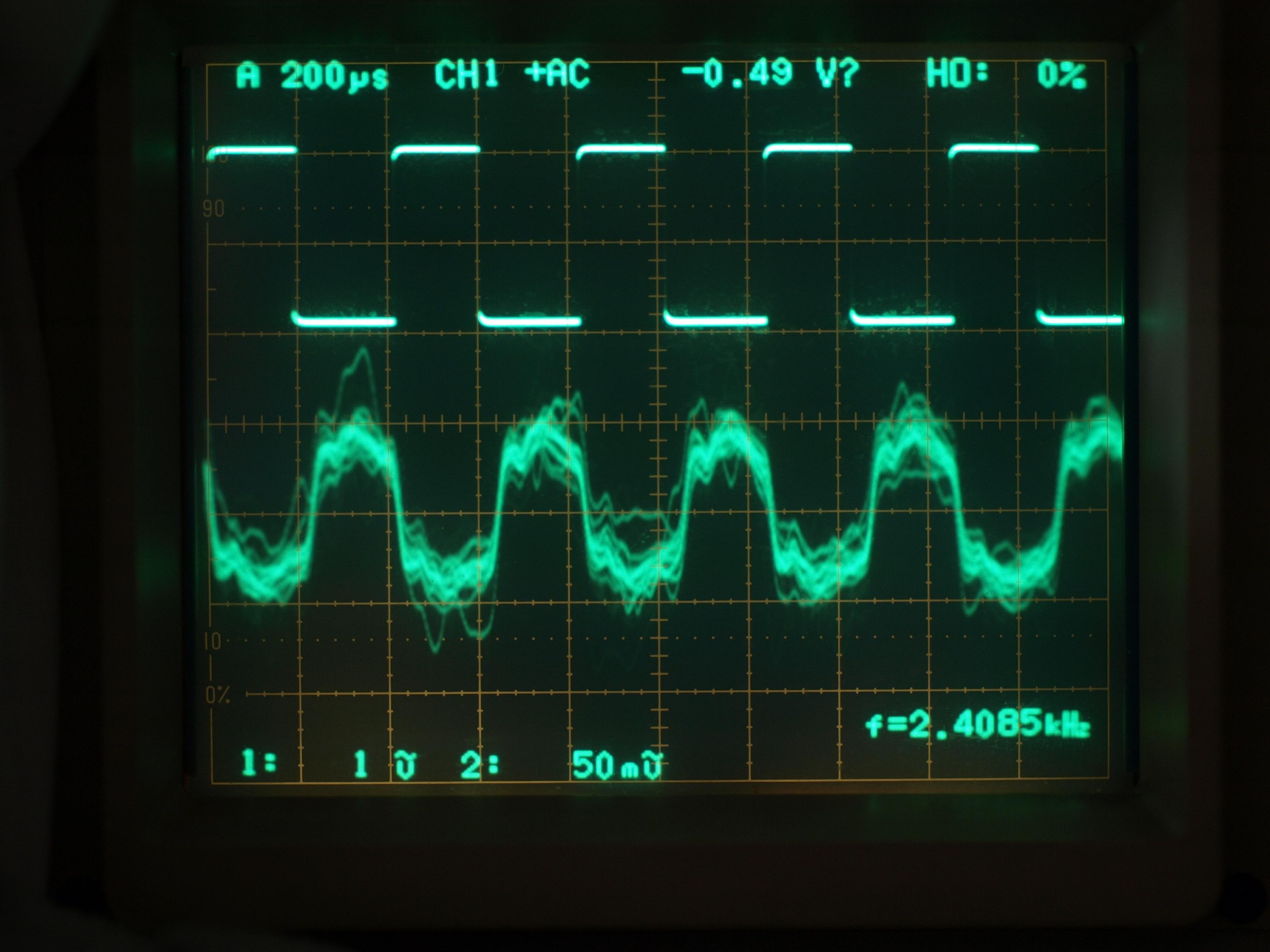

Bentront. Yes, The tone-burst signal is used to see overall speaker transient response and make sure the exact timing of TW WF matching.
The wiggling is caused also by a osciloscope cooling fan. Thank you for pointing that. So, I made a muffler by some cushions surrounding the scope. And, I changed the input signal from that of PC software and DAC generated to a normal CR oscillator which usually generate good noise free constant wave.
After the corrections, the pictures are much easier to see.

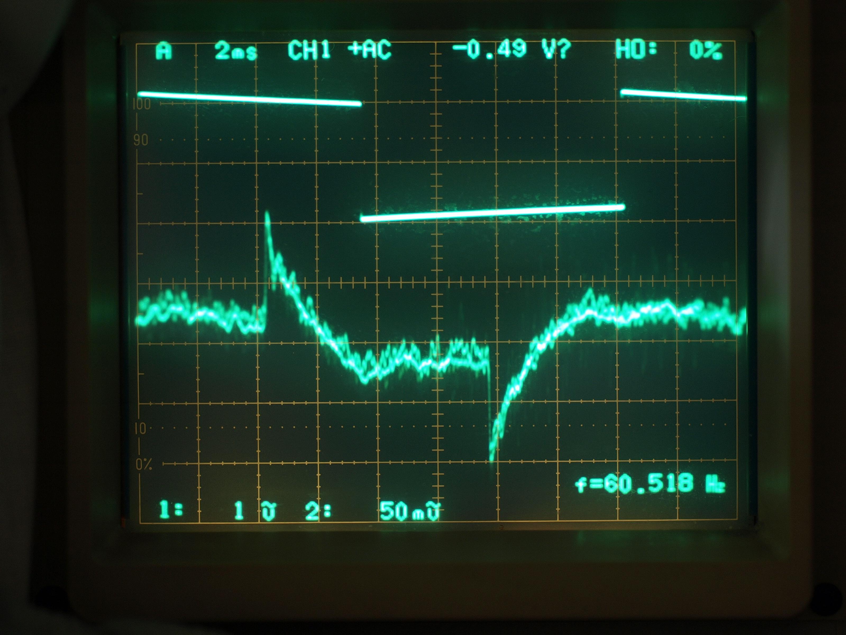

left to right, 60Hz,600Hz,2400Hz.
You see a shape of step response graph, popular measurement practice in Stereophile review reports, in the 60Hz test picture.
Speaker driver related noise and distortions are found in this pictures, I know.
From a developing TP crossover point of view, I am satisfied with the result.
The sound stage is deep and precise. Percussion is realistic.
