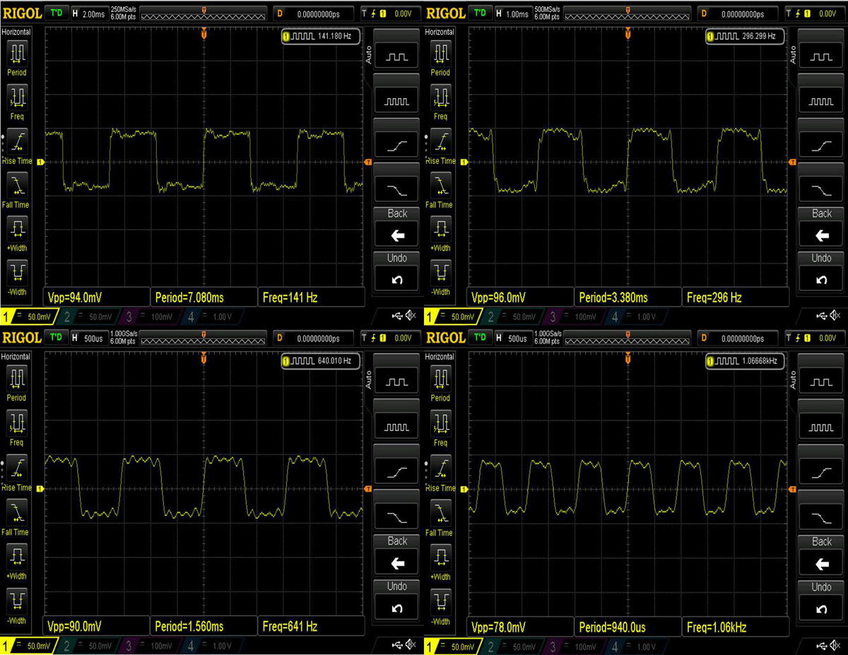

Well, here's a set only about 15 years late 😀
in case you ever peruse here ..
A coax compression driver in between two hornloaded and ported 12"s, Peter Morris's PM60, FIR processed.
I picked out some of the prettiest ones, but all looked at least decent below 1kHz.
They started going real ragged at around 2kHz.....if i remember right from a few years back when i took them..didn't save any uglies lol
I picked out some of the prettiest ones, but all looked at least decent below 1kHz.....
That's the point: you can fish around with your mic (esp up real close to the driver if most of the spectrum is coming from a single driver, and in the longer waves) to find a nice looking square wave and then move the mic a bit and - poof - the pretty square wave is gone. So when your speakers are playing square waves, purely an accident what shows up at your ears.

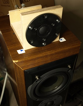

Interesting Thread. 🙂 As I am now building and testing original active 2nd order TP system.
I think that DSP based TP system probably be the winner in this TP field, but I also think this type of analog computing TP crossover has advantages over DSP , such as simple, low cost, real time etc.
I show you part of the square wave test result.
Speaker is a 2 way System crossed at 2400Hz by 2nd order TP slope; multi amping; time aligned.
Woofer ;Kenwood LS1001 woofer, 15cm paper cone
Tweeter ; Scanspeak D3004/664000 Be. fs; 500hz. temporally sub-baffle mounted.
Square waves are generated by PC.
Upper trace; Input signal, Lower trace; mic amp output.
The frequencies are 2800Hz, 2400Hz ,1600Hz and 800Hz.
You see the reproduced square waves are pretty close to the input signals. Wiggling in between rest time must be caused by vibration of woofer and/or front baffle.
