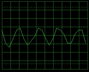

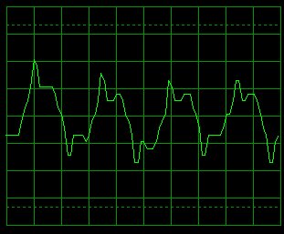

This is something I've been meaning to test for some time on my linear phase speakers, Delta, but I don't have an oscilloscope or open space to carry it out.
Still I thought for fun I'd try it using Speaker Workshop to generate the square waves & some Oscilloscope freeware and perform the tests in my listening room. The results are not too bad (see next post), although the measuring resolution is a bit course.

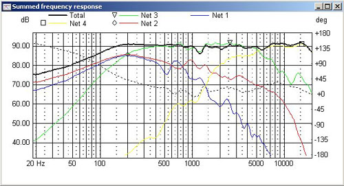

Below is the LspCAD predicted frequency response & phase of Delta.

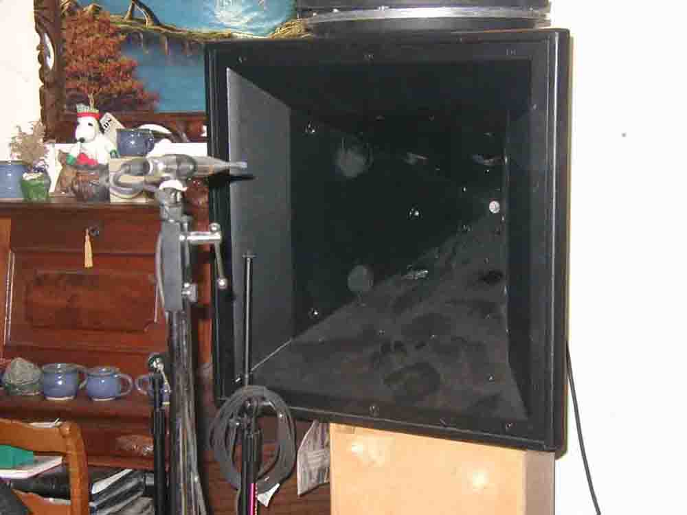

PB2, to answer your question about what I’m looking for, I designed a speaker for work that while it isn’t made for, or is small enough for the home, it does have the best imaging and sound I’ve ever heard in my living room. I’m trying to get a handle on what hifi speakers do time wise, how many can preserve waveshape and over what bandwidth.
I know there aren’t any pro sound speakers that do
The “goal” on all the full range speakers I’ve been working on is to make a multiway speaker that radiates as if it were a single source in time and space with controlled directivity down to a frequency set by the horns physical size.
I said the H word, yes, the speaker is a horn, part of what it has to do is be about 20dB or more louder than home speakers. The cool part here though is as loud as I would ever have it, they are still loafing.
The idea in this, called a Synergy horn (an extension of the Unity horn) was to use one horn body and drive is along its length, according to the expansion rate which is sort of a high pass filter for horn loading.
The physical position of each frequency range is offset by the phase shift in the crossover network and (when everything is right) you have what looks like a single source and the horn is loaded over a vastly larger range than it could be with only one real driver.

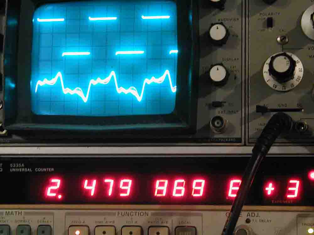

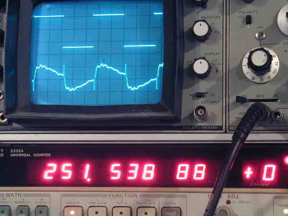

I listening to them last night and thought, “you know I should see what a square wave looks like”.
Anyway I set up and then took some pictures and that prompted my search.
I measured starting at 210Hz, where it starts to look like a square and then every 1/3rd octave above up to 3.15KHz where it poops out and looks like a triangle.
Picture 1 is the speaker, a dusty SH-50 in my living room, mic is an earthworks at about 3 feet although it looks closer from this angle.
Picture 2 is at 250Hz
Picture 3 is at 1KHz
Picture 4 is 2.5Khz
