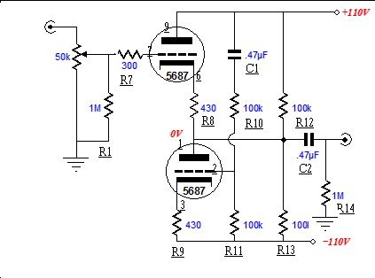

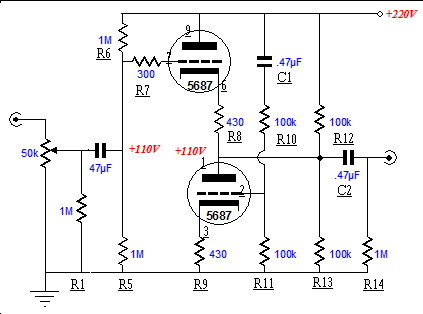

Now I will show my ignorance...the second part of the aikido line stage, that is, the buffer, looks much like Frank's WCF preamp, but it has got the 'noise cancelling' effect. Would a circuit like attached work as noise cancelling buffer? For perfect noise cancelling the values of R10 and R11 will have to be changed.
